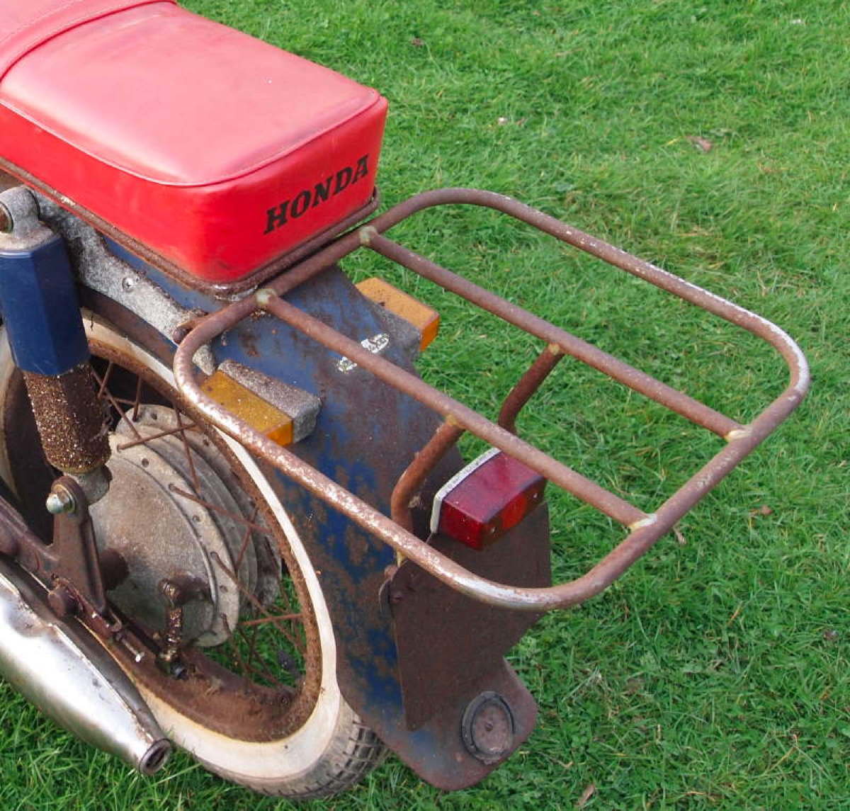

I don't know about the DREAM but I can measure the CB72/77.
It was BRONZE on the BLACK seat and RED on the BLUE.
The CL72/77 didn't have a logo on the rear. ...................lm

I can get you the size off my C72 but I may have a later black seat which I can some more details from. Will have a look later.

- Rear end small.jpg (181.95 KiB) Viewed 4185 times
- malcolmgb
- Posts: 401
- Joined: Mon Nov 07, 2011 11:52 am
- Location: Midlands UK & Cleveland OH
Thanks Graham, as I said I have measured the CA78 I have here in the US and a friend who wanted a stencil has finally confirmed his to be about the same, the colour is the issue now.I can get you the size off my C72 but I may have a later black seat which I can some more details from. Will have a look later.
Thanks Ed I hadn't realised they never put a logo on the CL.The CL72/77 didn't have a logo on the rear. ...................lm
