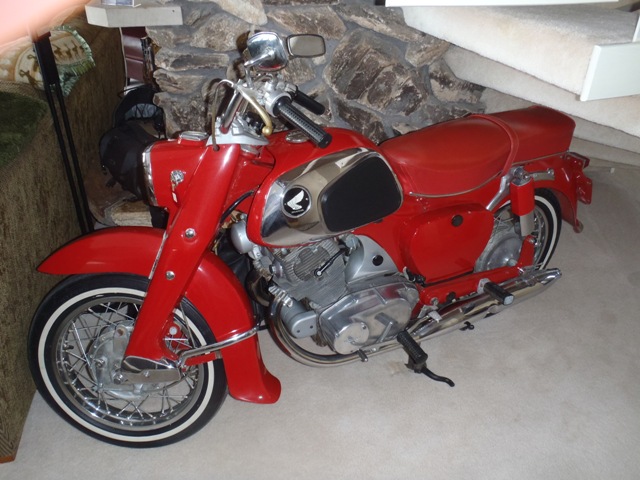

I added a pic of the bike...just because they're fun to look at!

- Feb 2014 014.JPG (56.38 KiB) Viewed 4364 times

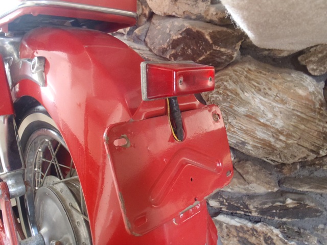

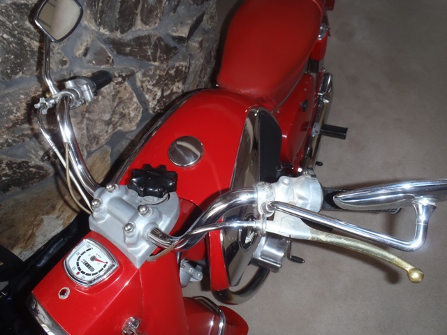

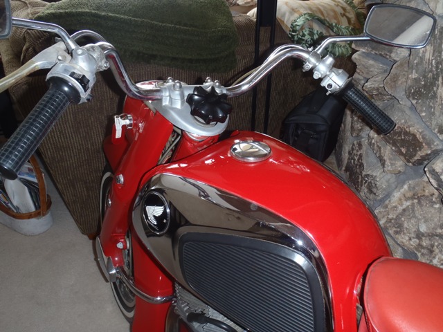

Please send some more pictures of the handlebar mirror mounts and rear light. Your engine would appear to be 1964-on. Th e1960 - 1961 engines had a lot of differences. There would have been a breather tower at the top left rear of the crankcases.

Also included a few of the requested pics. I'm interested in learning what I can...so any info is appreciated! MGH

- 4 Feb 14 001.JPG (52.8 KiB) Viewed 4235 times
- 4 Feb 14 002.JPG (60.82 KiB) Viewed 4235 times
- 4 Feb 14 003.JPG (54.49 KiB) Viewed 4235 times
