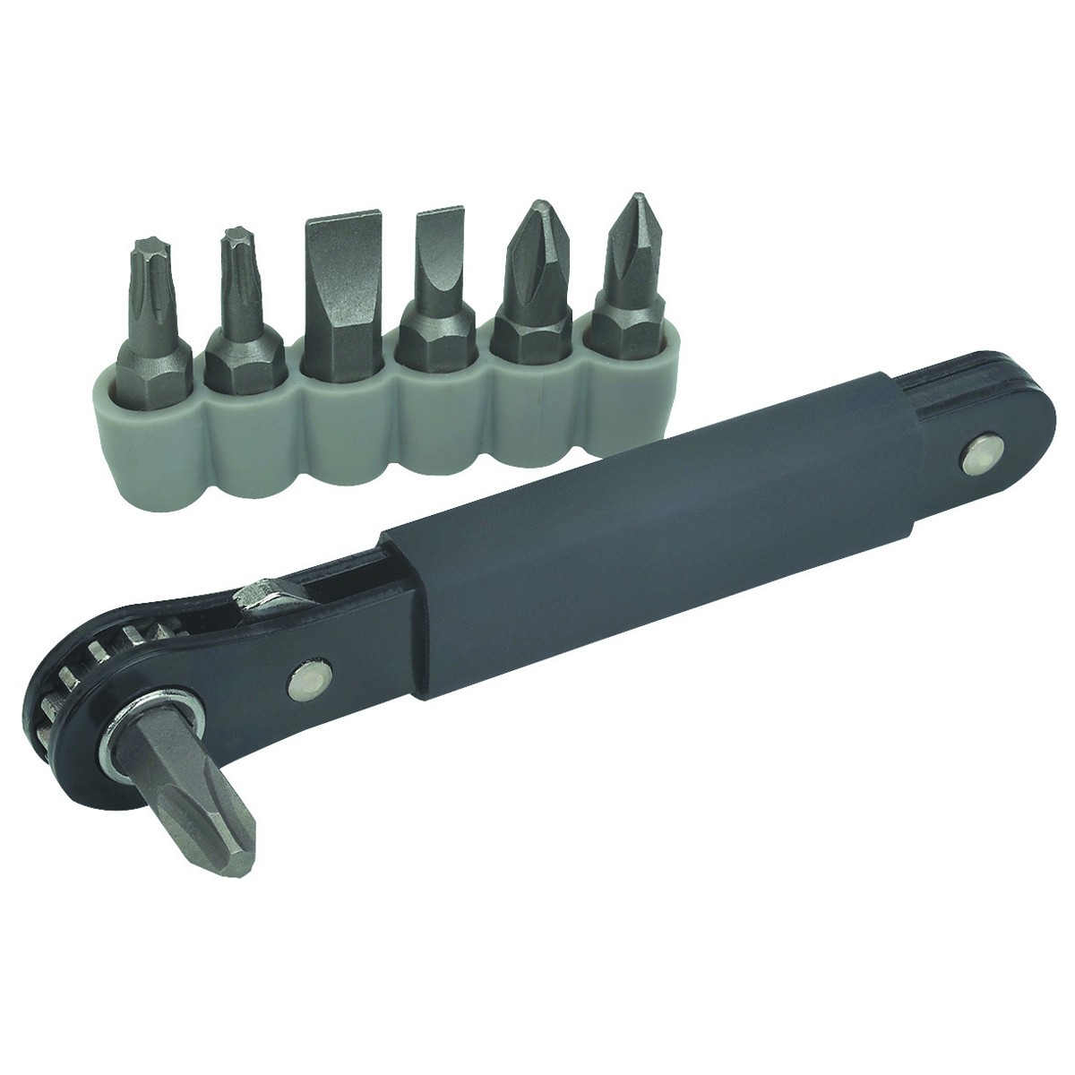

Just an FYI: I found this $4 tool at Harbor Freight. With a 2" long philips bit, it reaches the condenser screws on my '66 Dream, after the horn is removed. I swapped out my condenser in less than 20 minutes.
