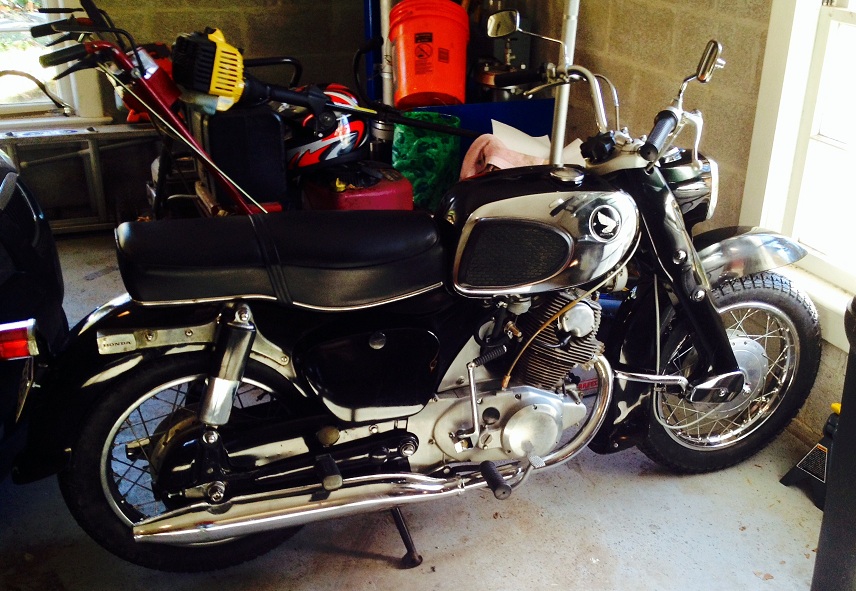

FWIW, here's a recent picture.
66CA78 v2.jpg (109.98 KiB) Viewed 5659 times
Post by brewsky » Tue Jan 21, 2014 7:41 am
Nice job!

Post by garncarz » Tue Jan 21, 2014 7:49 am
Brewski;
Just what I wanted to hear. Thanks for the help.
