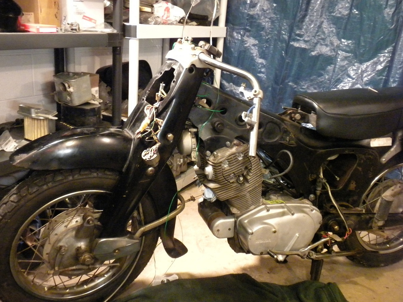

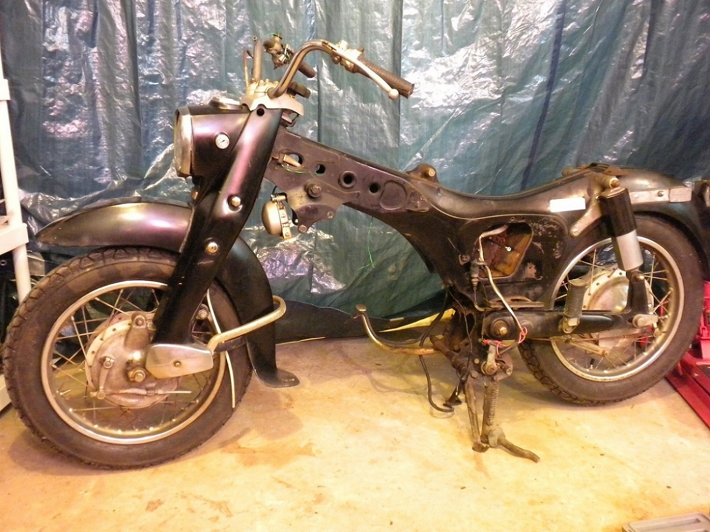

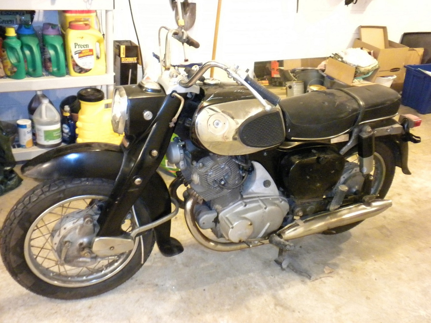

Thought I'd show you another person's attempt at not letting an old motorcycle slip away. I picked this '66 Dream up a little while back, and while the motor did turn, it wouldn't start. The PO had attempted a few things and obviously just decided to bail. I am hoping to have it ready to ride in the Motogiro in the Spring, so my goal is simply a mechanical restoration, and a spit and polish.
Got the motor out (that was a little harder than I expected it to be), and with the help of a friend, got the seals and tranny issues taken care of. The compression seems to be right where it should be, so I'll leave the top end alone for right now.

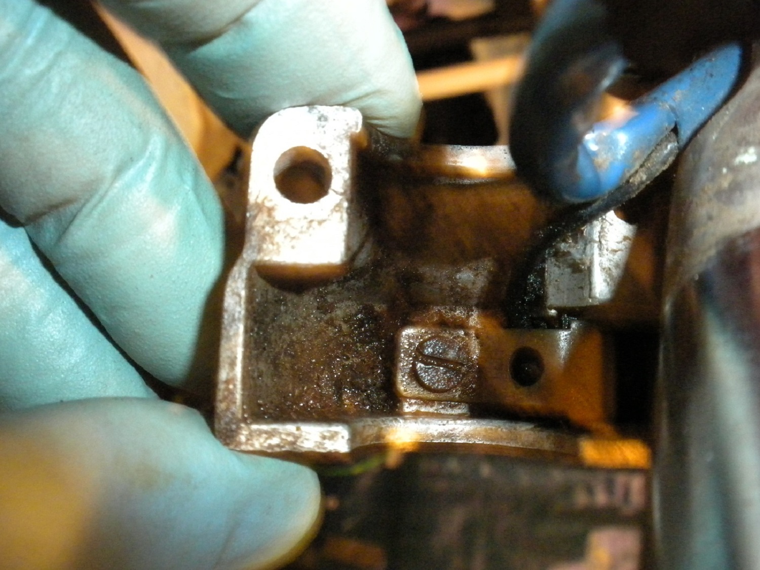

With only a little over 5K on it, I think it saw some rough use. A good amount of rust and all the cables trashed. But, most of it's there, and the PO put new tires on it. I've got new cables installed, motor back in, carb is clean, and the switches are clean (although I will probably have to post something in the "What part is this section, as I have a few extra parts from the Left switch...) This thing is getting close.

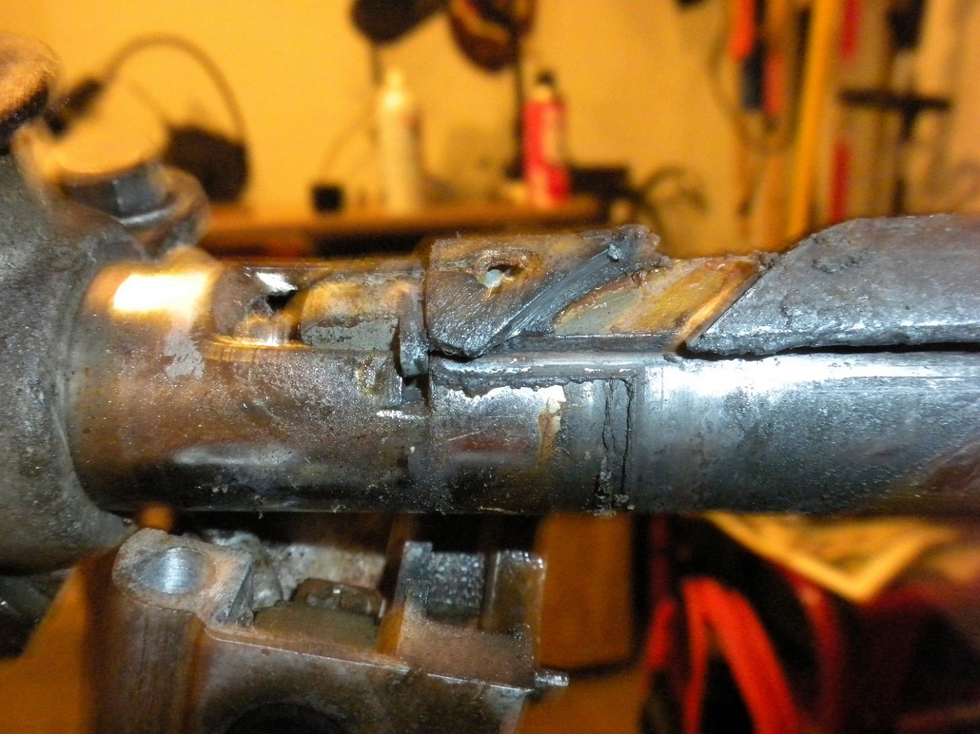

I've put in a pic of the handlebar throttle section before I cleaned it. I was unfamiliar with the Dream throttle set up and hope I can get it back together with out much fuss. I did clean the old grease off, is there a particular type of grease that should go back on?

I use white lithium grease on the throttle parts and tube/handlebar, and lube the cable with the "Cable Life" spray stuff. No matter what you do, it won't snap back like the "normal" style throttle. Think of it as a poor man's cruise control:) Welcome.

48lesco wrote:I use white lithium grease on the throttle parts and tube/handlebar, and lube the cable with the "Cable Life" spray stuff. No matter what you do, it won't snap back like the "normal" style throttle. Think of it as a poor man's cruise control:) Welcome.
-48
Mine snaps back just fine I did lots of cleaning and put on a new cable and lubed the new cable.

Guess it depends on your definition of "snap." Another thing that hangs them up a bit is an OEM grip on that side. It goes over the lip on the switch assy. and can drag a little. With an aftermarket grip that doesn't touch the switch, it can be more snappier.

Thanks for the info. I've got an OEM grip on this bike and an aftermarket one another Dream, and I'd say on that one it's probably more of a "snaaaaaaaap" :)
