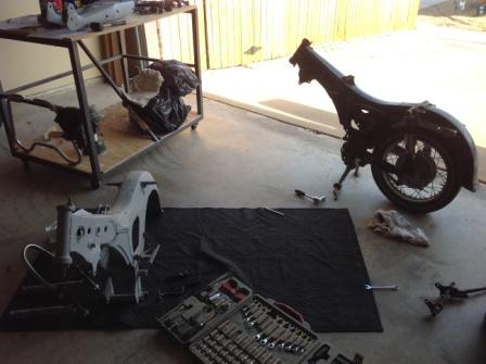

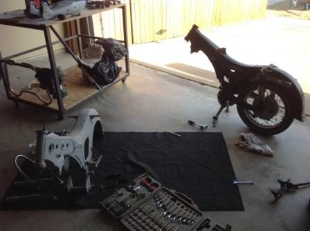

Attached is a random picture of both "bikes", well really just embellished frames with bits attached.
Thanks for any help!

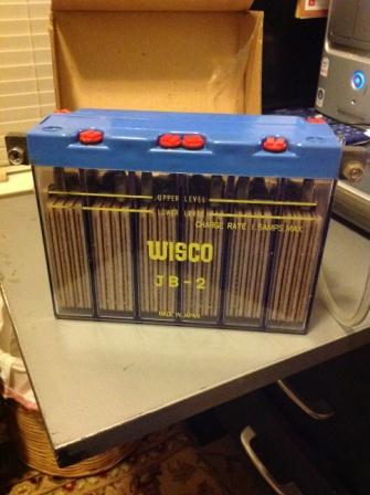

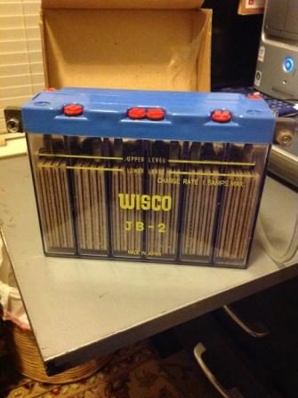

Some new parts
Fortunate to score not just one, but TWO of these jewels. Apparently these are as hard to find as the proverbial hens teeth. Dimensionally correct, this is the direct replacement for the Yuasa items that are no longer manufactured.
I am finding that the hunt for the items is almost as fun as the actual wrenching! I hope I can maintain the enthusiasm for the next couple of years, as I expect that to be how long it will take me to get this bike back together again. Anything short of that will be a bonus.
- Wisco JB-2.jpg (25.28 KiB) Viewed 2994 times

That's a really good outlook! I had first thought three months on my Old Girl...and here I am almost two years later. The hunt is fun, isn't it? There's research, and learning history, and meeting people...it's all so good!
Enjoy this journey!
