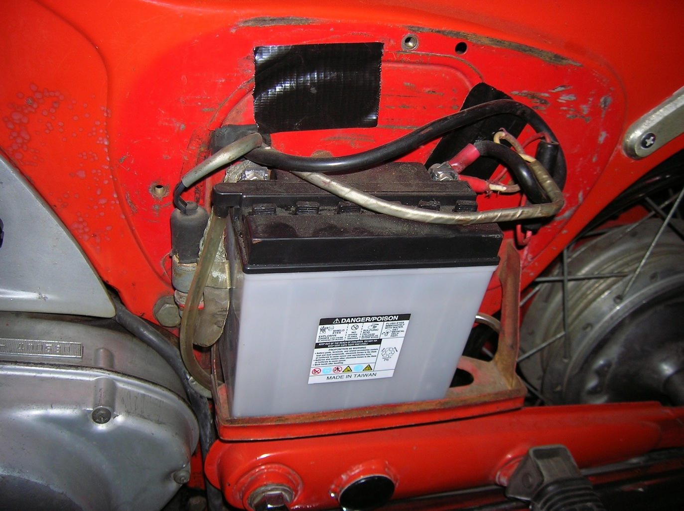

I have a 1964 250 Dream and was wondering if anyone has a clear photo(s) of a correct battery box/toolbox layout and wiring setup? Not a wiring diagram or exploded parts view, which I have, but something I can use to clean up the mess underneath the left side cover.
I ask, since I recently acquired a toolbox shelf and I plan to install it once I know how everything is laid out.
Currently the battery is installed with the battery terminals facing the frame, positive to rear, and I suspect that is wrong, but it came that way when I bought it and have been waiting until I got the toolbox shelf to re-do everything. You can see here how everything is laid out now, if it helps.

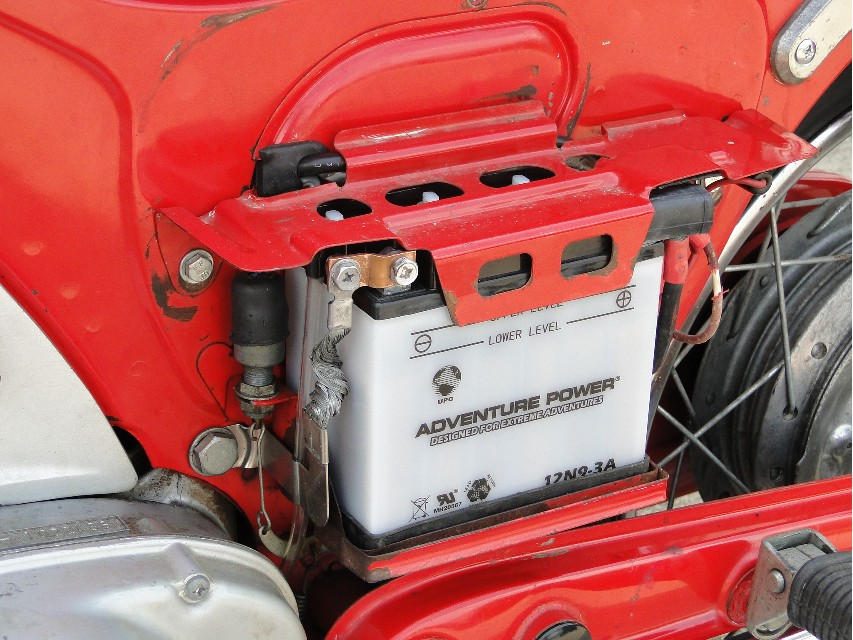

Post by RonBou » Sun Nov 17, 2013 11:28 am
Here's a photo from my 305. The 250 should be the same.
Ron

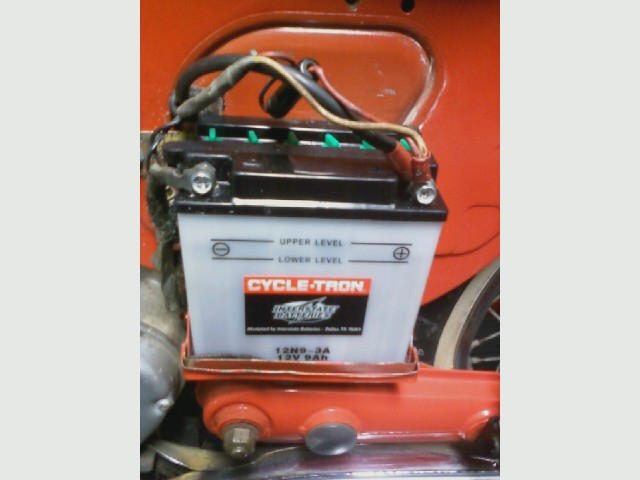

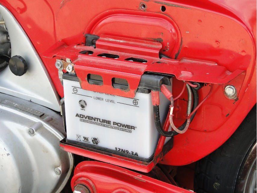

Post by 48lesco » Sun Nov 17, 2013 6:18 pm
Here's a couple of pics. Yours should lay out the same way. The early ones with the longer battery have a different tool tray.
-48
OldHarley
Posts: 29
Joined: Thu May 24, 2012 2:54 pm
Location: Dallas, Texas
Post by OldHarley » Sun Nov 17, 2013 9:50 pm
Thanks for the photos, they help. If someone has a photo of the early style tool box tray, I would appreciate seeing that one for comparison to the later style. The toolbox tray I have gotten sure looks like the later style, although I was assured it was the early style.
I definitely have the early style, longer battery tray in my 1964 Dream.
As you can see, I also have a later style battery (size-wise at least 5 1/4"x3"x5.5"), so even though it fits, it is not the correct one, and the terminals are backwards from what they should be. When I install this incorrect battery with negative toward front, the terminals wind up against the frame (or at least nearly). That's what had me corn-fused.

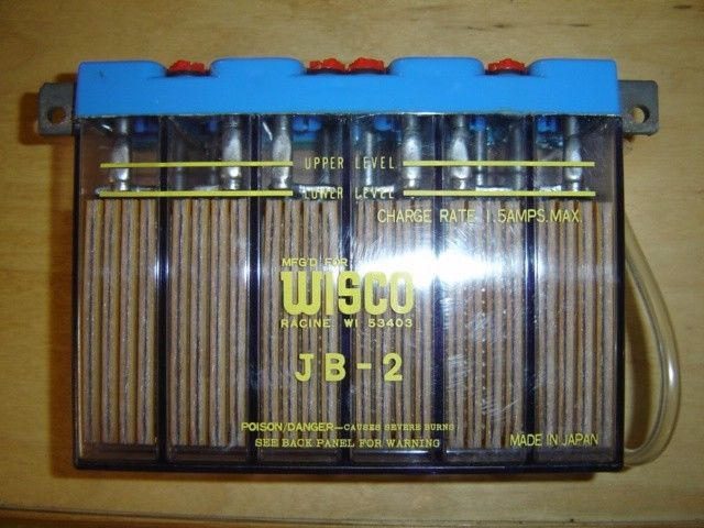

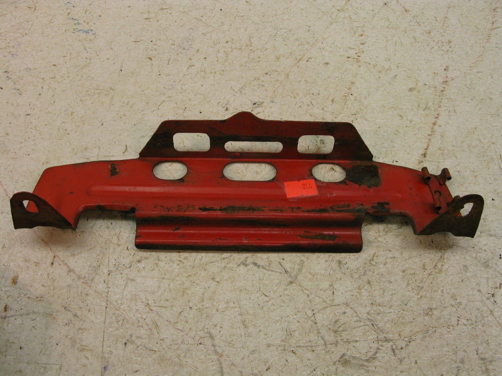

Post by 48lesco » Mon Nov 18, 2013 9:29 pm
Here's an early one on ebay, even though Mr. Monkey Claw says its a late one. The overhang that holds the battery is just a little longer than the early one. I attached a picture of a battery that appears on ebay quite often and would be correct for your setup; here's the link:
http://www.ebay.com/itm/Honda-CA72-250- ... de&vxp=mtr
-48
Batt Tray.JPG (296 KiB) Viewed 6452 times
CA77 Batt.JPG (58.18 KiB) Viewed 6453 times
