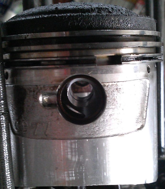

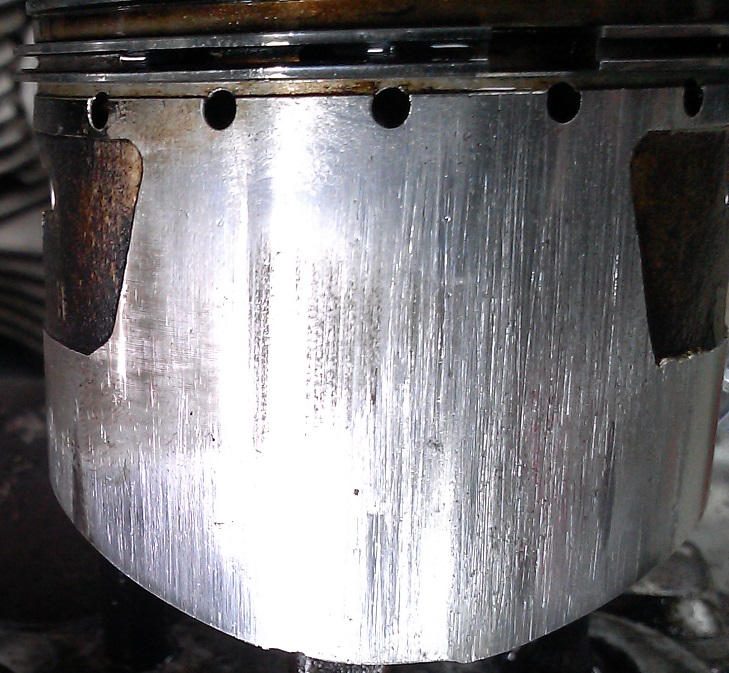

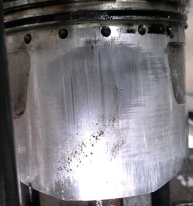

The machinist that I took some pictures to told me it was from a low octane gas being burned in it. Something I also noticed are some slight differences in the pistons. Oil hole spacings are different on them, as well as the piston that is shot seems to have a taller crown (or at least from compression ring up seems to be higher). Also, the 'good' piston has cb77 stamped into it, as can be seen in the photo. The final killing factor on the right piston is that when I pulled the cylinders off of the rest of the engine, a piece of the piston on the inside around where the wrist pin clip is was broke off and fell out on my starter motor.
