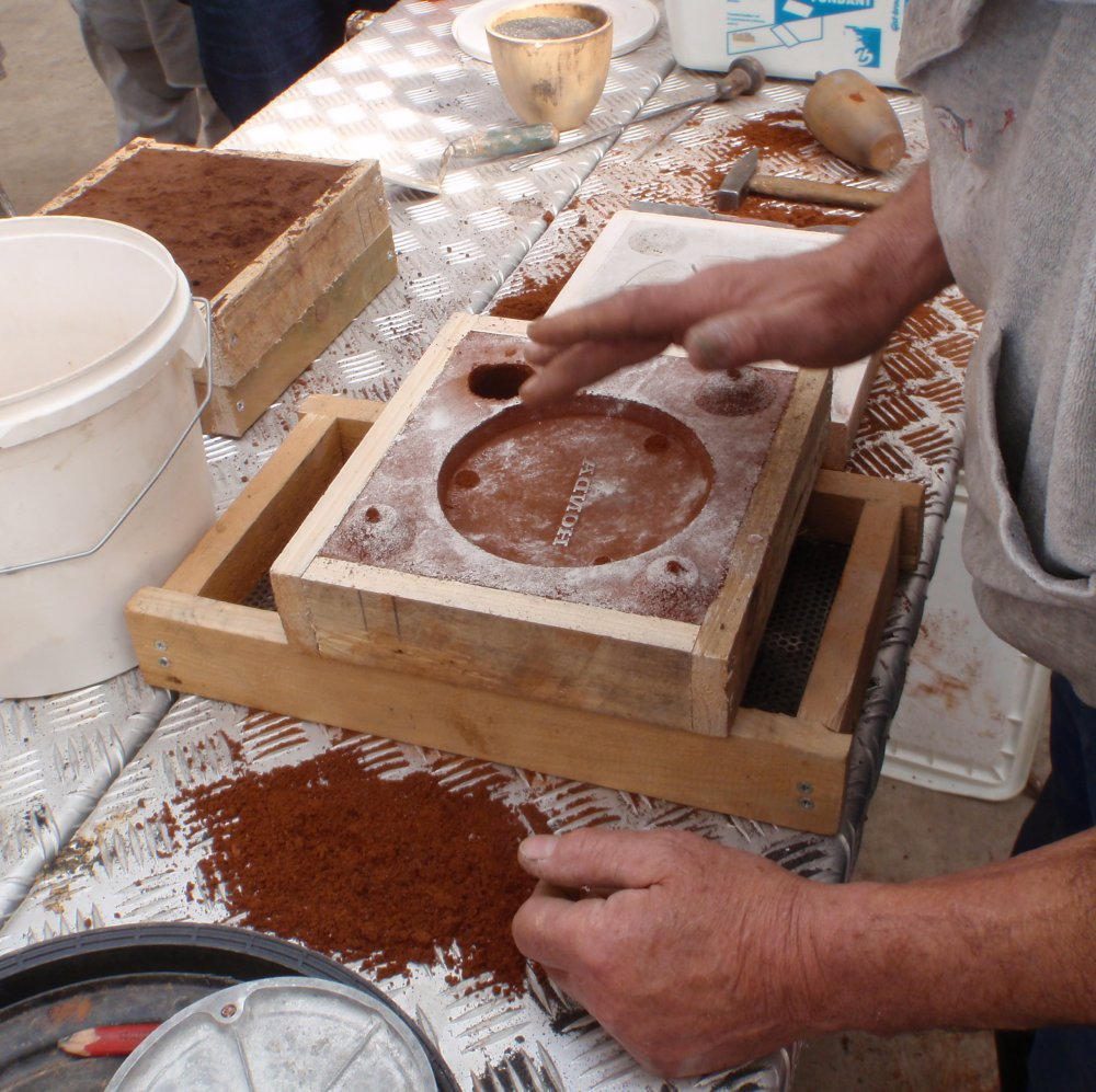

Nice! I guess you're using the original part there as the pattern. That's ok with simple parts but the part produced will be smaller than the original. If the part has to it closely to something else that is a problem.
Sand casting would still be the preferred method for what I described above. Casting that side cover would be a bit of a challenge. Die casting dies are 10k plus.

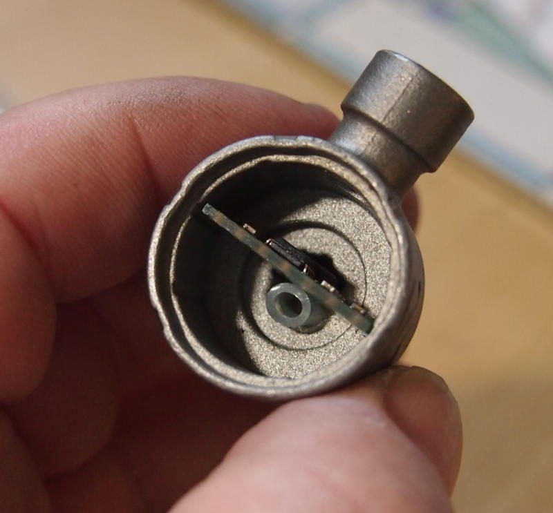

Investment casting is nice but not so easy for bigger parts. It is a 3000 year old proces invented by the Egyptians. My rail sensors are investment-cast stainless steel.
