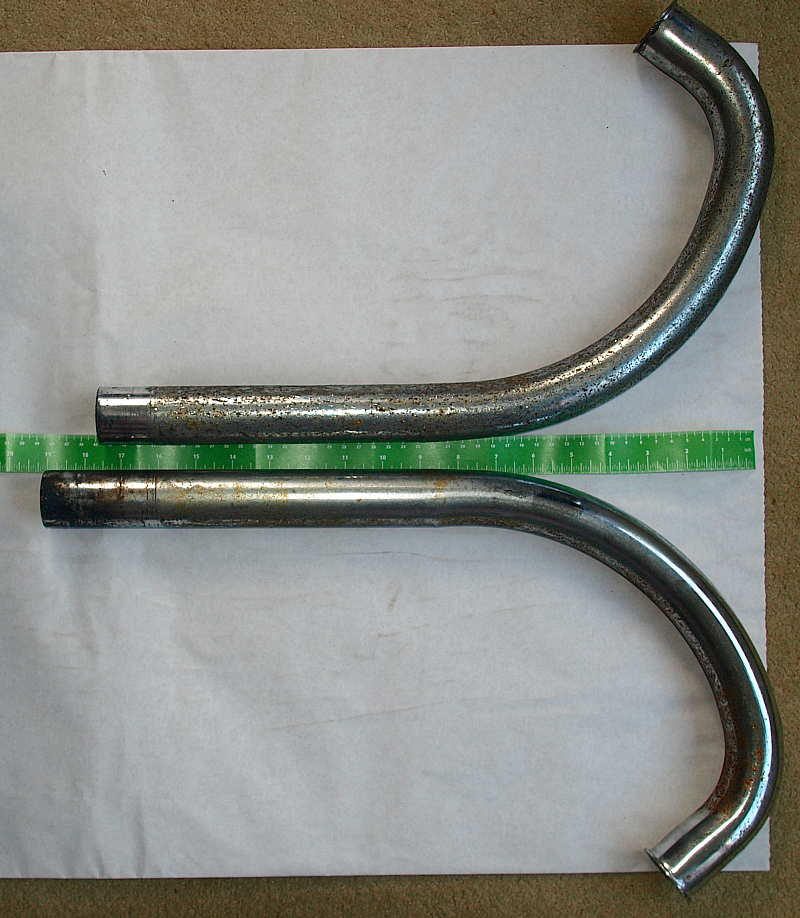

This a pic I took for one of the posts.
If you mount the two mufflers you will see that the front end of one mounts ahead of the other - hence the different length pipes.
If you don't have OEM mufflers then you don't need to worry.....
