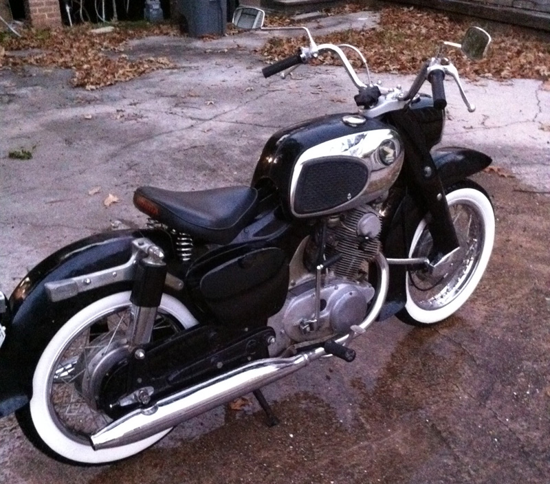

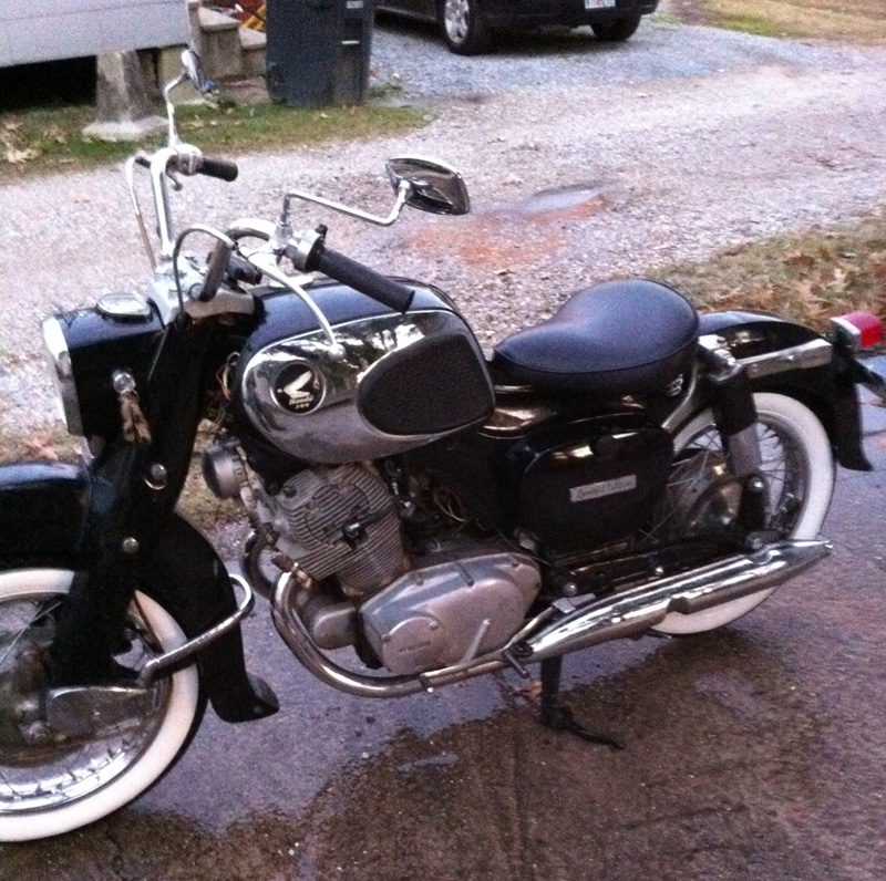

Also, since I've been on the forum for the past year - I figured it about time to post a pic of my dream.
Thanks guys!
