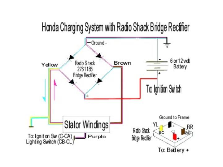

Here is an easy way to solve your burnt out/defective charging system rectifier, using either components from Radio Shack or your local electronics salvage or retail business.
The wiring diagram is below and the following page shows the components as assembled by Scott Kirn and forwarded to me for the benefit of Honda fans everywhere.
(For the Honda 90’s substitute pink for brown on the diagram)

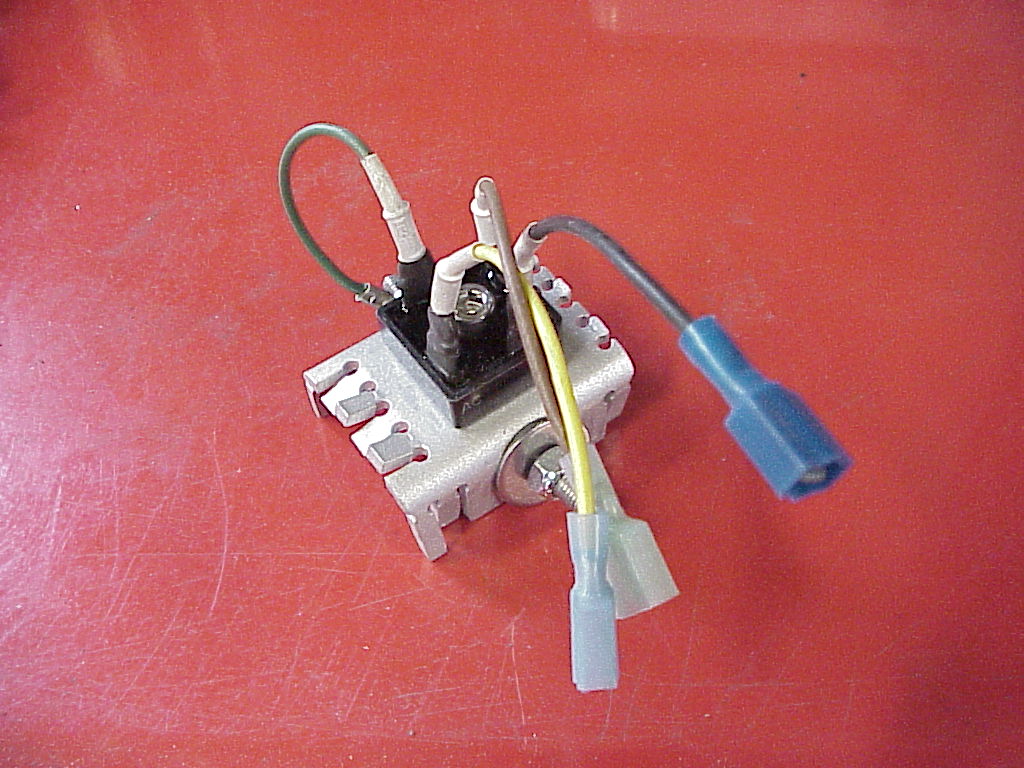

Scott used a surplus bridge rectifier (KBPC2505), rated at 25 amps, plus a suitable heat sink. Total cost was less than $5. The mount bolt is a standard 6mm x 30mm bolt in this case. There is a possibility that engine vibration could cause the one-side mount to fail or loosen. A loose (ungrounded) rectifier is NOT a good thing. An alternate mounting method could be to use a longer threaded bolt or a piece of “all-thread” from a hardware store to allow a full mounting on both sides of the bracket. Mounting on both ends of the bracket will dissipate the heat better, as well. Use of a full sized mount bolt will allow for central mounting of the rectifier and wiring.
When attaching the charging system wiring, either make up some adapter wires to match the OEM wiring ends to the spade mount terminals or just cut the ends of the wires and crimp/solder the terminal ends on securely. Try to use the correct size wire gauge terminals. With Scott’s central ground terminal, you must be careful not to allow the ends of the terminal to touch any of the adjacent terminals. Obviously, this would ground out any AC or DC voltages at the rectifier, causing a loss of charging system output at the very least. Run a short jumper wire from the central ground terminal to the Neg (-) terminal on the rectifier, to complete the chassis to rectifier ground circuit.

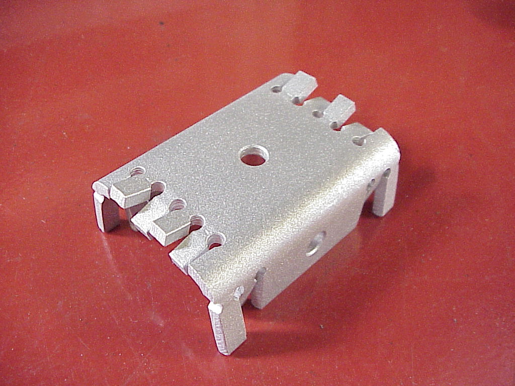

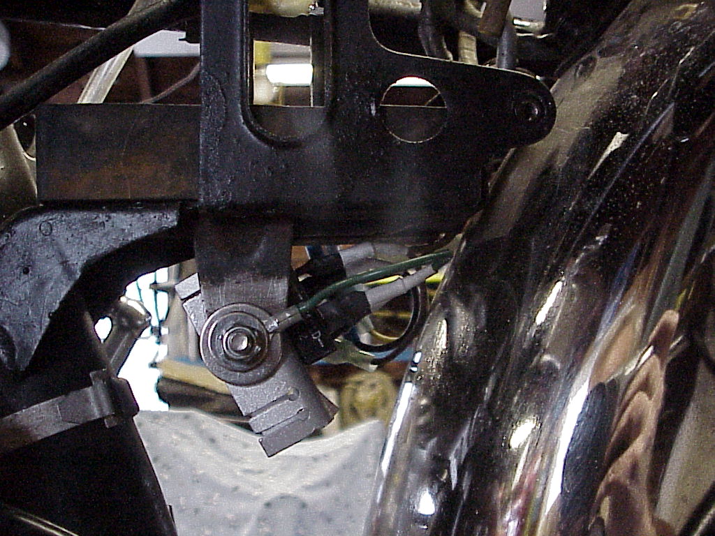

Here is the finished mounting bracket which also doubles as a heat sink. I made this from 1/8" alum sheet stock.
Note that the picture of the sink alone is slightly different than how it looks in the picture with the rectifier mounted on it. I had to trim that back side down a bit so I could mount it as shown in the pictures of the assembly installed on the bike. The length of the sink when finished was about 2-1/8" x 1-5/8", the narrower of the two being the width between the mounting ears on the bike frame.

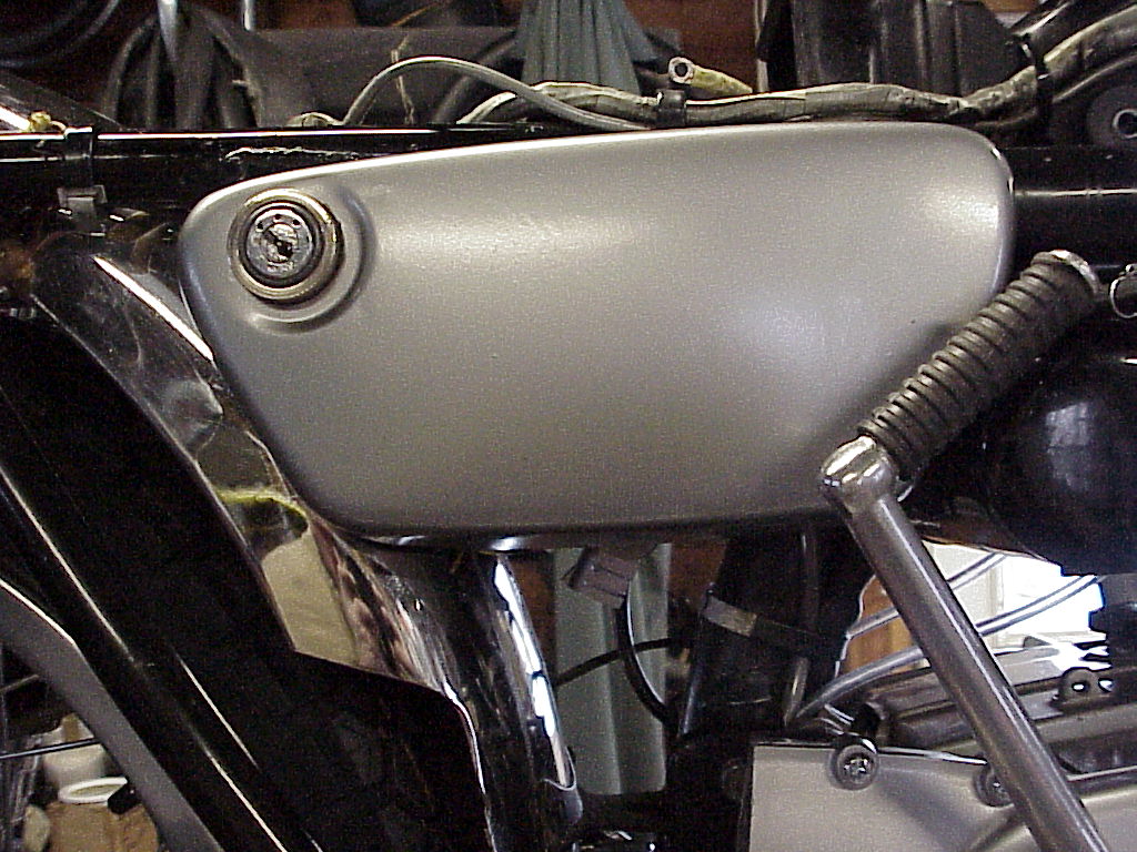

The only visible portion is the end of the sink sticking out below the side covers. The original could be seen as well and you really have to get down on your knees to see it when the bike is sitting on it's stand.

OK the two wires from the ac stator. Does it matter which side of this rectifier they go to? And why dosn't the third wire from the stator go to the rectifier? That dosen't seem right. WHy?

Narly9999 wrote:OK the two wires from the ac stator. Does it matter which side of this rectifier they go to? And why dosn't the third wire from the stator go to the rectifier? That dosen't seem right. WHy?
quote]
The brown and yellow wires go to the rectifier.
The pink wire goes to the ignition switch and connects back to the yellow wire when in the "lights on position".
There is a wiring diagram and switch matrix sticky in the Electrical section.
Here:
http://www.honda305.com/forums/viewtopic.php?t=6088
