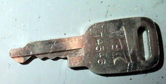

I have a CA77 with matching ignition and steering lock that both have T4346 stamped into them. I bought the key below that also has T4346 stamped into it (it was only $6 inc shipping so I'm not upset with the seller..). The key won't turn the ignition, but if I pull it out about 1/16" from the steering lock then the steering lock will turn. ..... I'm not sure if this key was cut correctly, or maybe the pins in my tumblers are the problem.
Does anyone have a T4346 that they can take a photo of?
thanksmuch!

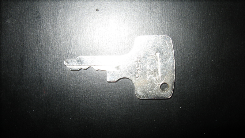

Hope this helps.

Might want to be careful just going by the numbers. Even though it looks different from yours, this key is also cut, not an original Honda key. It may or may not be right.
