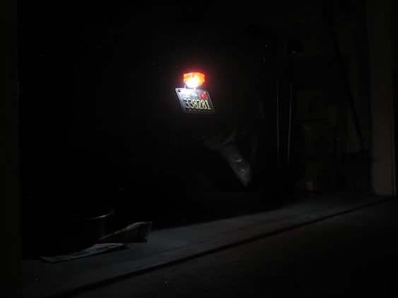

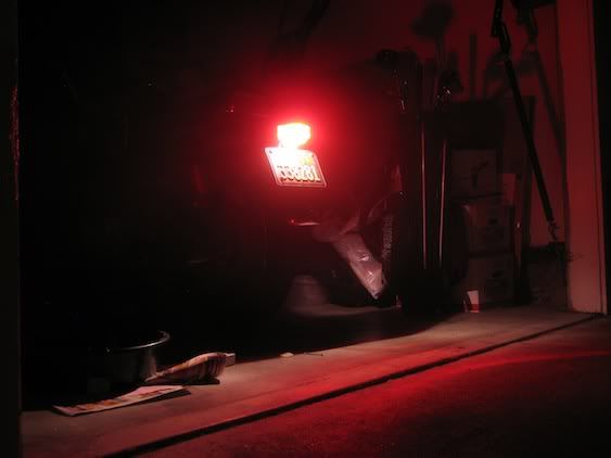

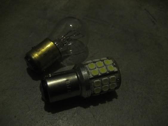

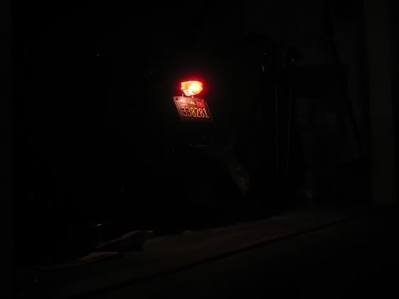

I bought this LED light and from superbirght leds and wanted to just show the differences I found
The bulb is a BA15 45 High Power LED Tower bulb, color white (1157-W45-T). It cost $24.95. I found it here. Below is a comparison of it to the incandescent bulb. I used my camera on manual setting, so none of the settings changed between the shots, i.e. no exposure times changed.
Here is the without the brake light:
Incandescent:
LED:
With brake applied:
Incandescent:
LED
At 12 Volts, this draws 35mA (brake NOT applied) and 235mA (brake applied). [ stats here]. Thats 0.42W and 2.82W. Does anyone know how this compares to the incandescent?

That's less than 10% of the power consumption of the incandescent type (taillight).
Good & bright too! I like the difference in light output between the tail and stop; mine (LED-Ace) isn't that much brighter between the two modes in comparison to yours.
