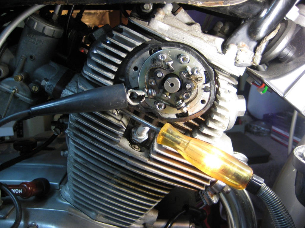

Another drawing(!), mainly for noobs; this time of the points' components. For Type-2 motors, only one set (obviously).
I'm posting this as I know some have found that there's no spark after re-assembly; this drawing places the components in the correct order. To clarify: the fibre washers sit either side of the POINTS BRACKET LUG -- the fibre ring fits inside the lug; this insulation is vital! There's no need for a spring washer under the nut as the entire assembly is under constant tension from the spring steel; just snug the nut up with a 6mm spanner or nut-runner socket.
The insulation can be tested by clipping a 12V test lamp between the motor and each set of points' tag-screw in turn; with the ignition ON -- and if the insulation is good -- the lamp will light when that set of points is open.
De-mystification -- points' components' order of assembly
