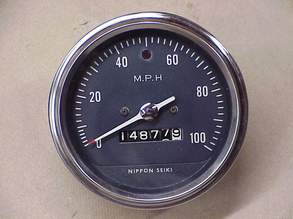

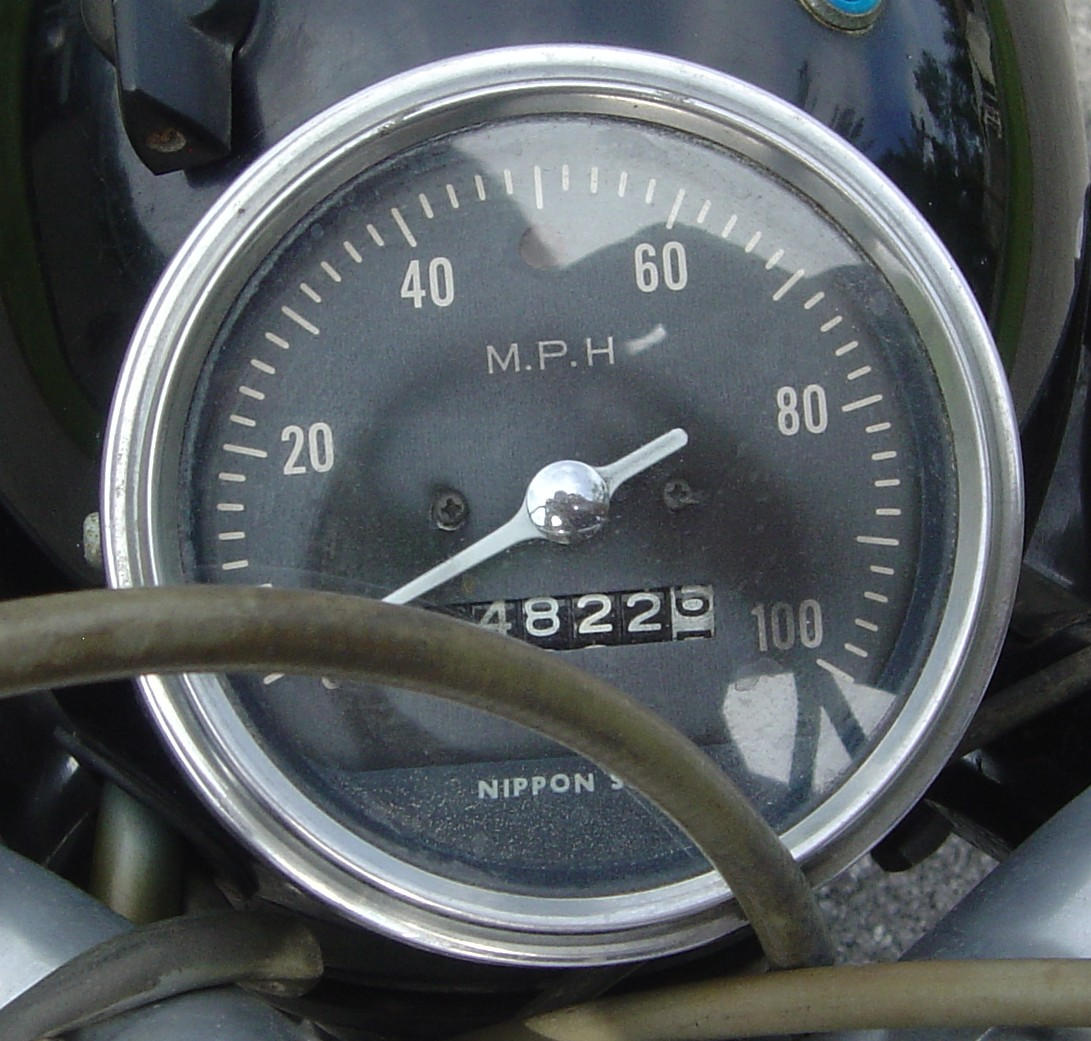

Before and after rebuild pics.
Speedo as it came with the bike and before cleaning and rebuild.
Speedo after rebuild and cleaning
