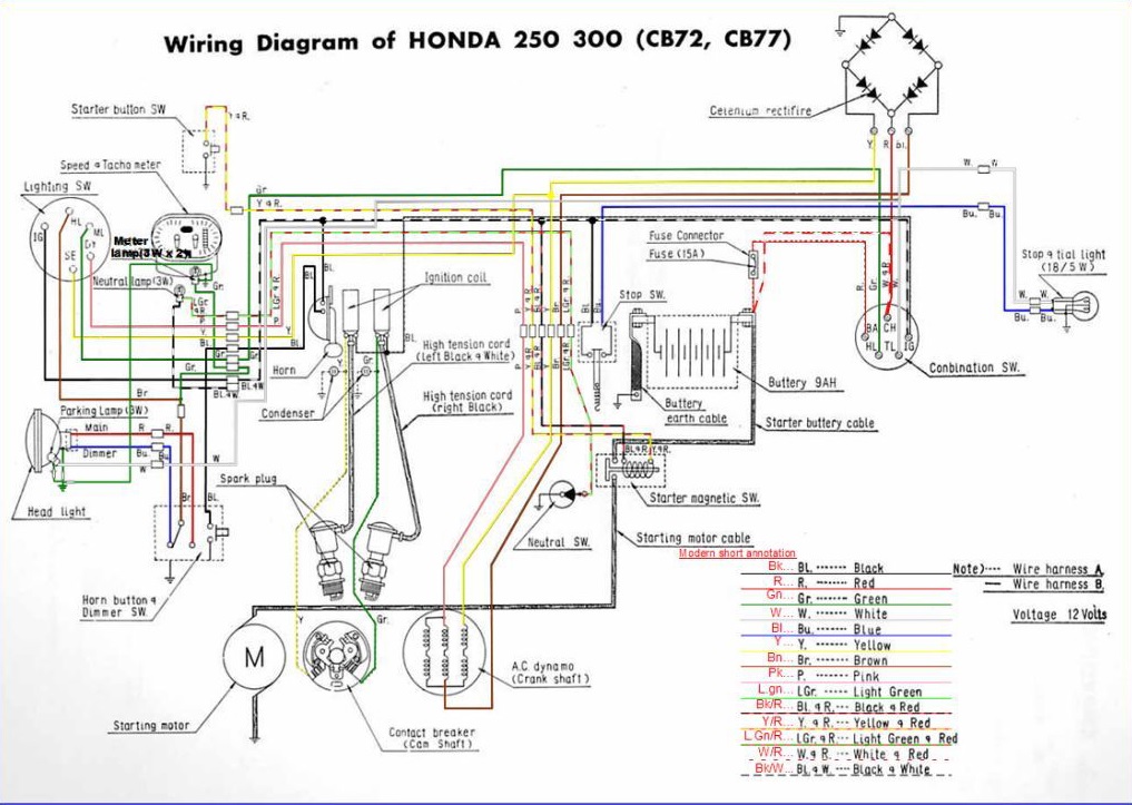

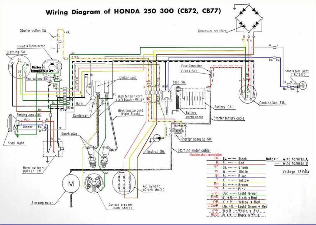

I noticed yet another error in the original Honda wiring diagram, corrected herewith. There should NOT be a connection, shown as a green wire link, between the headlamp switch brown and the meter lamps' green wire junction receptacles. I've edited the connection out of the equation. Bill Silver mentions a correction that he's had edited, but I can't find reference to it now.

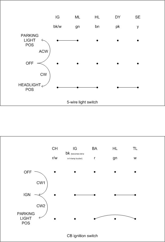

The second pic here is a pair of schematic matrices showing how the CB/CL 5-wire lightswitch and the ignition switch operate. Terminal CH on the ig sw has no connection to any other at any time; it's purely a junction to connect the battery r/w (direct and unfused, which is why it's a fibre-covered cable) of harness 'A' (charging & ignition harness) to the rectifier red (sometimes r/w -- mine is), also fibre-covered or -sleeved, of harness 'B' (main harness). I suggest that this r/w cable should be fused also.
EDIT: it seems that some dimmer switch wiring -- my NOS included -- contains a green cable to the dimmer centre (common) contact, not brown as is shown in the diagram.

Thank you very much! I was about to ask this very question. Does this mean that the "CH" post is not needed but that a second red wire can be run from the rectfier + to "BA"? Again, thanks for the post. Karl

sprocket wrote:Thank you very much! I was about to ask this very question. Does this mean that the "CH" post is not needed but that a second red wire can be run from the rectfier + to "BA"? Again, thanks for the post. Karl
Yes, I guess so.
Post by e3steve » Fri Jun 24, 2011 5:05 am
Actually, no, Karl. If you need to bypass term 'CH', wire the rectifier +ve straight to the battery terminal, via a 25-Amp fuse; the fuse will protect the harness against the rectifier shitting the bed and going short-circuit.
The reason to not connect the rec +ve to term 'BA' is: if the 'main' 15-Amp fuse fails whilst the motor is running, then the alternator will put unstabilised voltage >20VDC onto the electrical system. Adios lamps and, possibly, ignition system!
