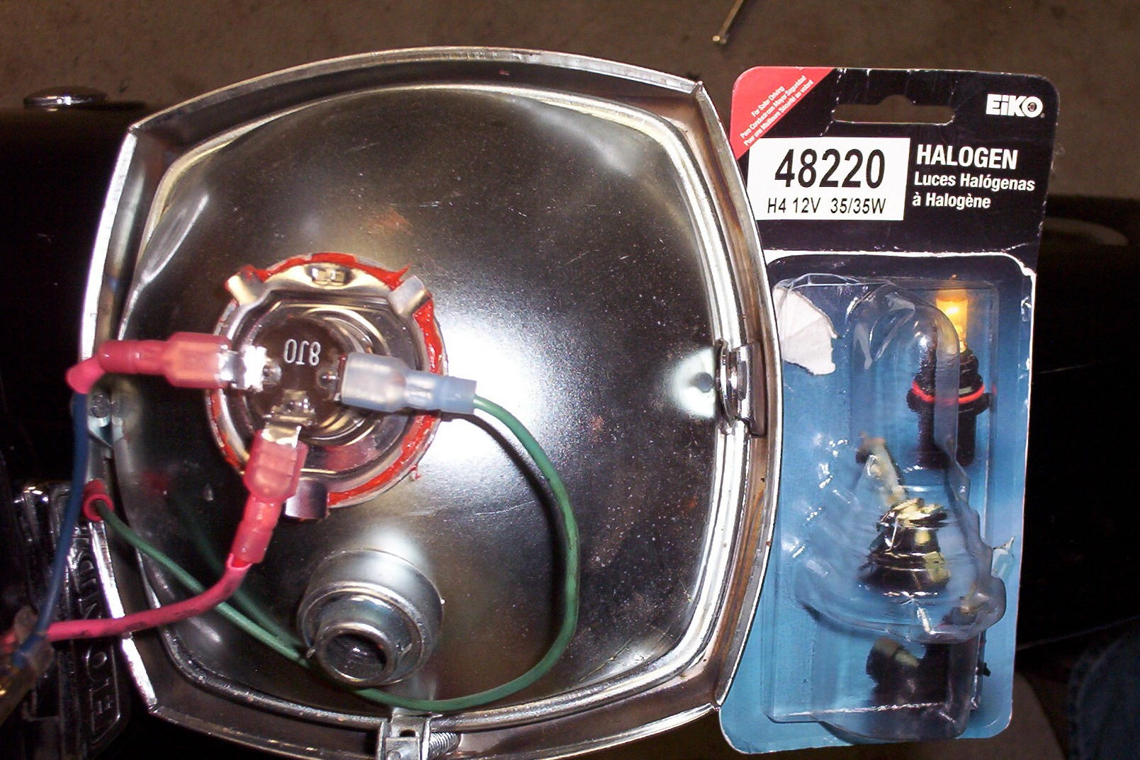

Here is what I did with the aftermarket light housing.Not sure if many come up for sale anymore on Fleabay.Very simple.Also, I saw where a guy was able to cut slots in the back and had a socket from another bike headlight and it had prongs that would hook into the glass.Not sure what bike it was from but it worked very well.

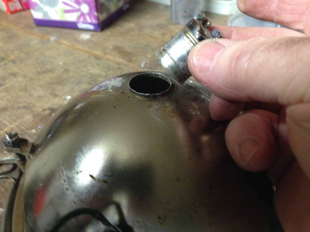

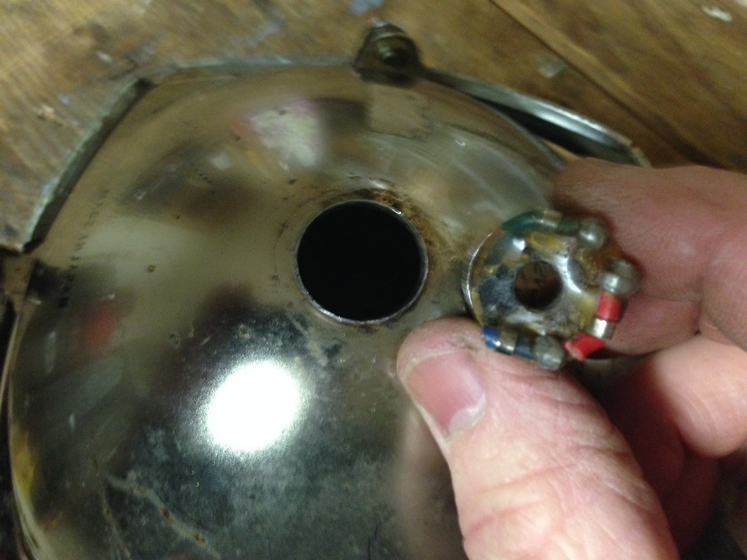

Thread resurrection, but I wanted to report that I successfully removed the bulb from a sealed beam headlight today using method #2. I used a soldering iron and swept the molten solder away with an acid brush as I went around the socket. Then, I supported the bulb socket with a pair of pliers and drilled down through the center with progressively larger bits. I broke the bulb with a piece of coat hanger wire, bending it as needed to get to the sides of the rather large round bulb inside the headlight. Afterward, I stuffed a length of Swiffer dusting material on a string into the headlight to mop up the dust. Tomorrow, I'll go to the auto parts store to look for a bulb and high temp silicone. I'm thinking it might be better to use the back end of an auto headlight socket as outlined in method #1, but I don't have access to a junk yard.houseowax wrote:I want to do this too. I'm still dealing with other issues and haven't gotten around to tackling this one, but I have watched the forum for any information I can find.
