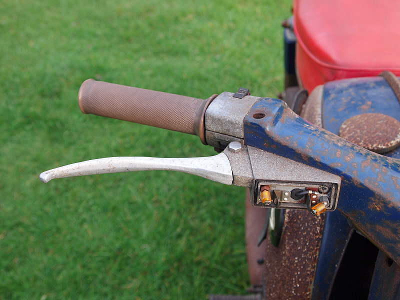

You appear to have 8mm ones for the early Dream with Pressed Steel handlebars. You probably need 10mm ones.
The 7.54 you mention is 8mm as 8mm is never really 8mm you need to have clearance fo rthe two parts to fit together.

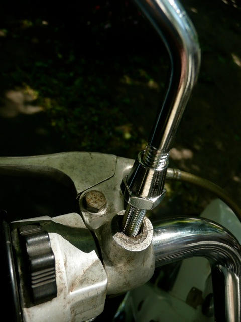

I'm attaching a pic of the mirror's threaded stem set into my perch so you can see the difference. It's hitting the bottom/bar in the pic so you can see there's quite a bit of threaded stem there. My understanding was that 8mm was what was used in earlier model bikes; the switch to 10 mm came later (mid-late 60's?).
My bike is a '63- does this mean my perches have been switched out? I'm not THAT much of a purist that it would matter to me; just trying to understand my bike and it's history a little better.

Yep - looks like you have later perches. You could get 10mm mirrors or look for 8mm perches. The long threaded portions of your mirrors are for bikes like mine with the low pressed-steel handlebars. On those bikes the mirrors go in a threaded hole that goes right through.

Your perches appear to have had knackered threads and, therefore, probably been re-tapped to M10 or something imperial (instead of being Helicoiled).
Run the locknut all the way onto the mirror stem and cut the threaded portion off at 20mm protrusion; file the cut end flat then run the nut to the cut end to clean up the thread.
Two possible perch solutions:
- 1. Pick up a Helicoil or Recoil re-threading kit from any good tool shop; these come with their own tread-repair tap.
2. Get a new pair of perches off eBay
