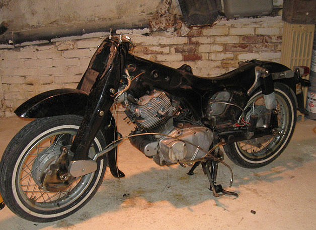

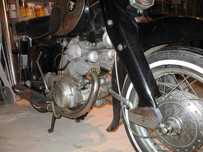

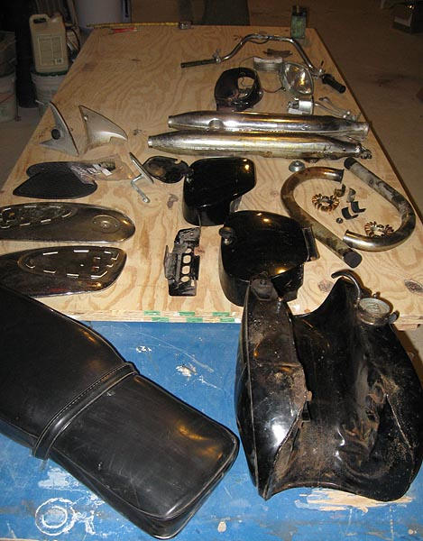

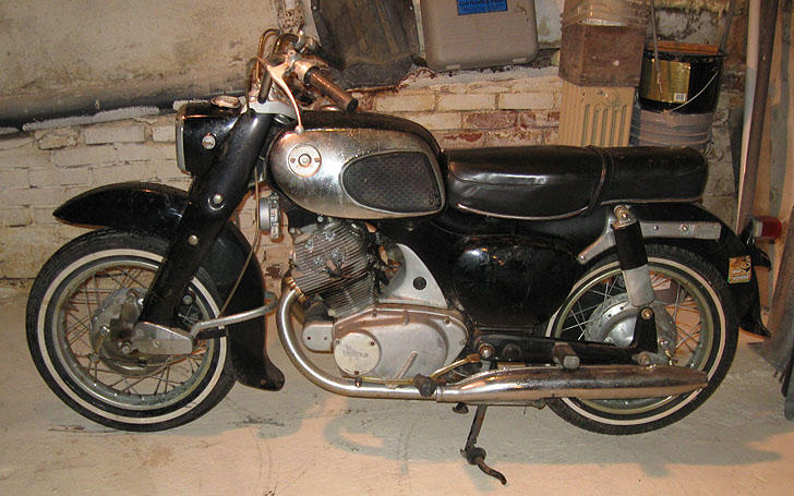

I just got this bike today: couldn't resist starting to break it down. I've never rebuilt a bike, but I have done a few cars inside and out so I'm not worried. I'm sure there's a lot of good advice to be found here so I'm going to keep a posting of how I'm doing, feel free to post anything in here.

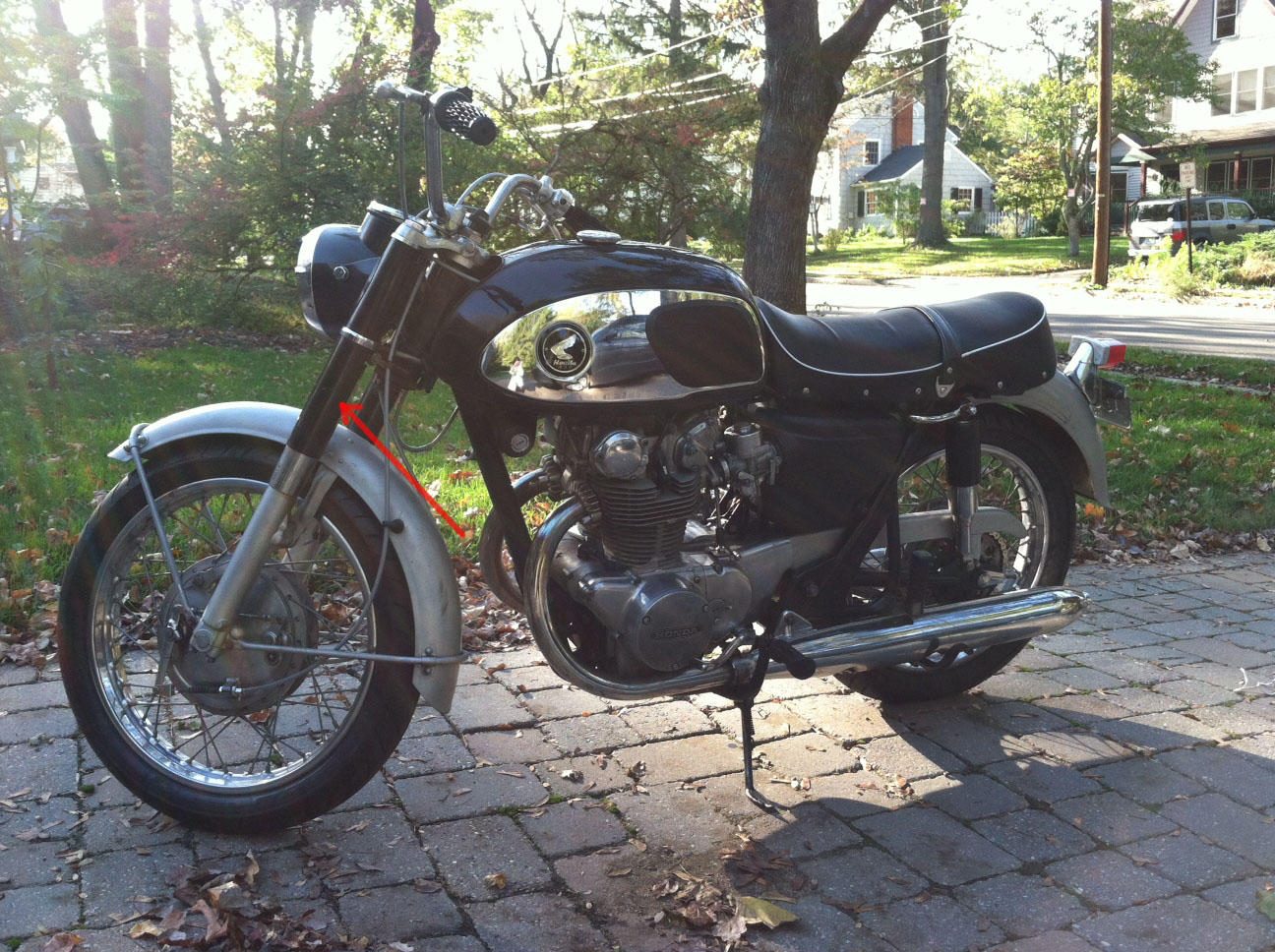

well. some time has passed, other projects have come and go. now i finally have the dream back together and running beautifully. started on the first kick...
the paint was all redone in gloss black BC/CC urethane. nothing was rechromed, just thoroughly cleaned. disassemble, clean, polish, paint and reassemble was really the bulk of what i did. replaced all the cables as well. rebuilt the carbs. it's been so long. reading my old posts i can see that i have too.
