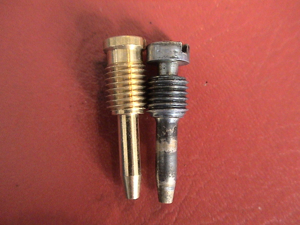

Post by brewsky » Wed Nov 04, 2009 5:43 pm
Maybe this is why some need the ring and some don't?
Attached pic of my old air screw beside new Keyster replacement.
If the o-ring goes just under the head, then the screws explain why.
