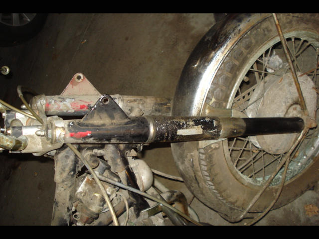

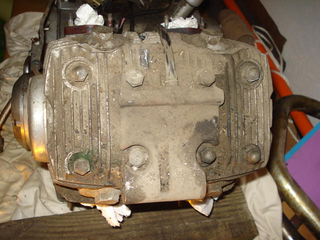

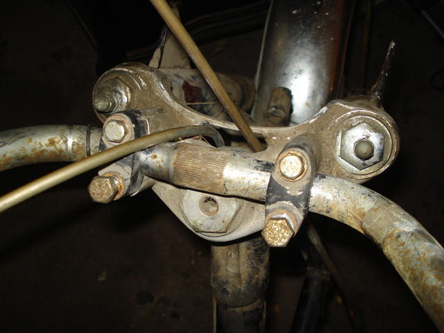

I bought the bike from a neighbor and friend, essentially he gave it to me. My friend bought it in 1969 or 70 and rode it until 76 when he stored it. The bike was free, I trust the guy, and the engine hums after 30 years..but there are some issues. I knew it was a honda, but it had some crap on it from unkown bike (fuel tank, seat, tailight, "engineered" headlight can) The frame is CB77, the engine serial number is long gone (undoubtedly some nefarious activity from two owners ago). I think the engine lower is a CB72, at least the magneto says so, but I really can't tell at this point. I have my doubt about the upper motor as it doesn't have a place for the engine hanger bolt closest to the rear of the bike, but all of the other mounts line up. I don't think the front end is CB at all. The yoke has an additional brace between the forks, with a small hole in the center(just right for cables and wiring possibly) and no lock or adjustment handle.

pics of motor and stering brace
was a bit dirty--still trying to identify the motor and front end

That front end and cyl head breather/top-plate looks pretty well stock as far as I can tell from the pics. The brackets attached to the upper mounting bolt seem to be crash-bars. The chrome fender was stock during the '67 production run, but not with those fork legs that you have (yours appear to be type-I; type-II had alloy lower legs and 'caps' clamping the axle). Your fender has an odd-looking mounting brace where it attaches to the fork legs, so I'd say it seems to be from another bike!
It looks as though the top yoke (triple-tree top bridge) had been modified, probably to facilitate the cables' path after the 'engineered' headlamp was fitted. The handlebar isn't correct for a CB; could be from a CA (touring), with those centred splines(?).

All CB rotors were stamped 'CB72' or 'CB72L' (lower magnetic output). The motor's cc is stamped in the lower-front of the cyl fins.I think the engine lower is a CB72, at least the magneto says so, but I really can't tell at this point.
We'd be interested in a better pic of the 'brace' that you describe. I can see the boss, for the steering lock, poking forward on the bottom yoke. The damper (adjustment handle) ass'ys are aplenty on eBay.The yoke has an additional brace between the forks, with a small hole in the center(just right for cables and wiring possibly) and no lock or adjustment handle.
