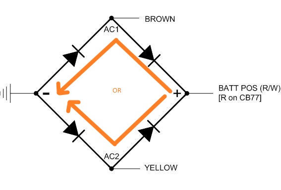

The rec is shagged; most likely, at least two of the diodes between the positive output pole -- there are two pairs, each in series and that series paralleled with its neighbouring pair (see pic) -- and ground pole are shorted.
Replace the rec and the burnt cable; check close-proximity cables' for their insulation integrity.

Most likely, E3 nailed the problem as bad rectifier shorting the + battery terminal to ground thru the rectifier.
I will see if I can confirm this with a meter and let you know.
I could find no other short to ground anywhere in the harness.
