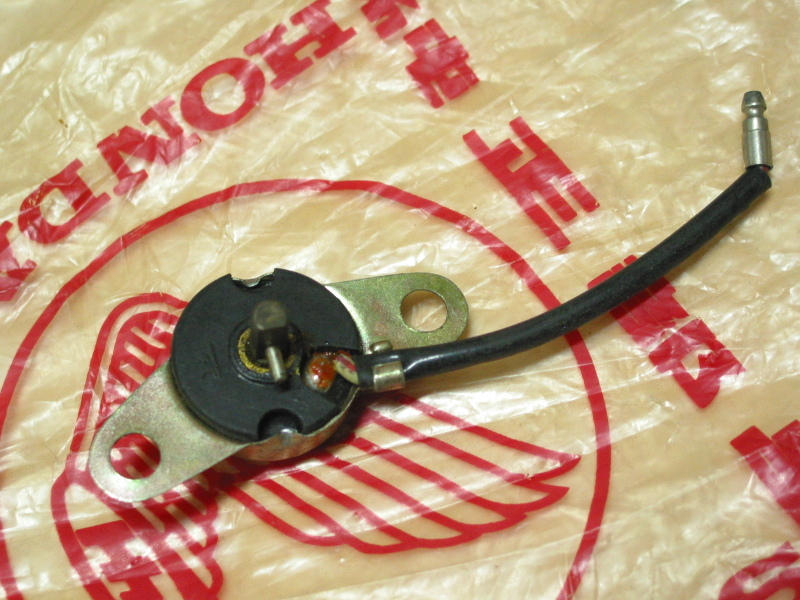

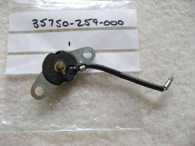

Post by G-Man » Fri May 15, 2009 1:00 pm
These are the two switches. Any idea why they have different numbers?
259 model
259 model
268 model
268 model

Post by G-Man » Sat Jun 13, 2009 3:50 pm
I spent some time looking at these two switches side by side and the contacts make / break at exactly the same orientation of the switch. Mounting holes, came length, cable colour and connector are all the same. I'm pretty sure (until you tell me different!) that they are the same part.
35750-268-000
35750-259-000
David Silver spares in the UK has stocks of the 259 part.
