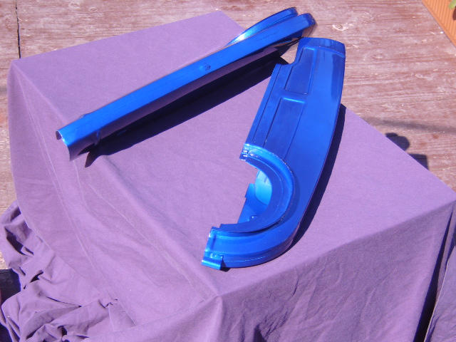

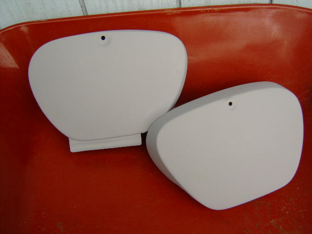

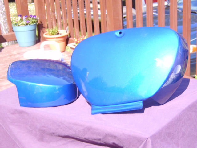

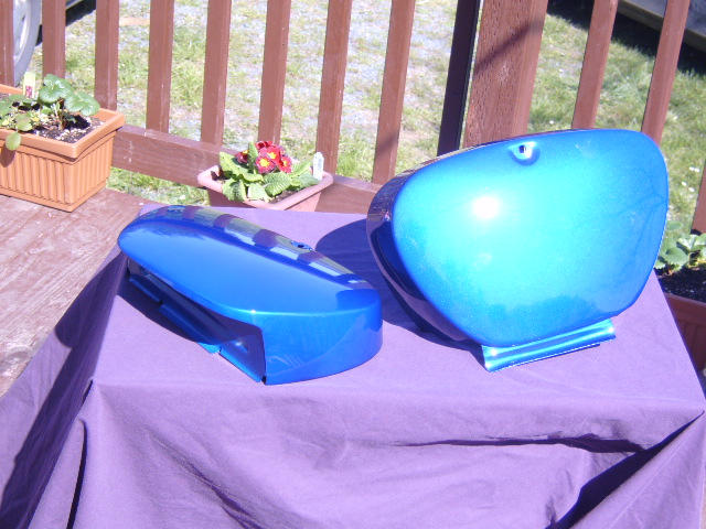

Got some pictures out of the camera and am going to try posting them:
If all goes well comments will follow.
these are pictures my daughter-in-law took for me, the primed side covers were taken on a cloudy
day and the ones taken after painting are over-exposed as the paint is darker to the naked eye. Got to get a decent camera. The paint looks great but I am surprised how easily it gets fine scratches in the clear coat. The painter said I would need to buff it out but to wait till after I get the bike assembled, probably so I can touch up the scratches I make getting it togther.
Had a little fun getting the paint to the painter; the paint shop told me to bring in a piece of the bike and they would "shoot it with the camera" to get the color code they needed to mix the paint. When I get there the camera is broke so I pick the closest match from a catalog of a coupla hundred colors. With these 60yr old eyes the blues kinda all look the same so I pick a likely looking shade and then find out that they are out of the blue pigment for that color and it would take days to get some from Eugene. So, as I had the painters waiting for it, I choice a car paint they had the proper pigments for. It's a Toyota code called ,Spectra Blue, Dupont no. f4486 k
