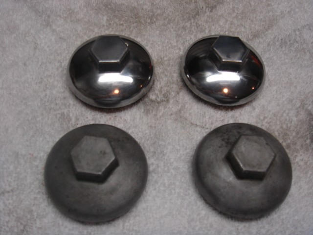

Aluminum polishing
Post by eyedragaknee » Wed Feb 04, 2009 6:20 pm
Start with 320, 400, then 600 and then you should be able to buff it. Put a little dishwasher soap in the water you are using. Just a couple of drops in a bowl and that will help you a lot. Go to 1000 and 1500 if you really want it nice. You CAN't hurt it.
Don't use anything heavier than 320 or it will be a bitch to get the scratches out by hand.

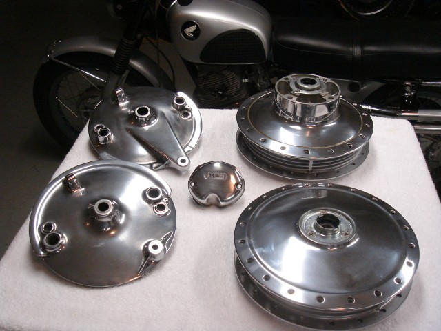

Post by eyedragaknee » Wed Feb 04, 2009 9:30 pm
Just did these tonight. This is only a 600 grit finish and buffed. Not show quality, but better than anything Honda did back then, I believe.
