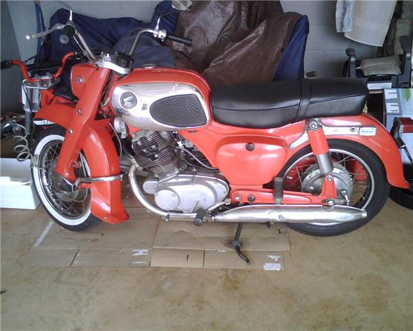

Background: 67 CA77, 12K miles
Bike sat for 4 yrs prior to aquisition. (was told ran good prior to being parked)
I have: cleaned fuel system, tank and rebuilt carb. Rebuilt petcock and installed inline filter
New points (timed, adjusted) and condenser, new air filter and oil. New plugs, trimmed back wire leads to caps.
Was running great for the last couple of days
So yesterday, Im on my longest ride yet (approx 6 miles). Suddenly, cuts out and dies. No lights-nuthin. After sitting for approx 25 mins, it starts and runs for about another minute and cuts out again. Then no start at all. My hunch is it is electrical related (nuetral light wont come on either). Is there something that can go bad when it heats up, then might work a little when it cools back down?
Does this sound familiar to anyone? Any suggestions would be greatly appreciated.
