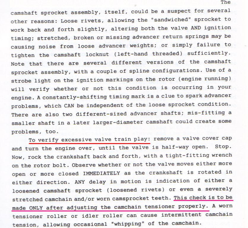

    3. check that there's no valve train backlash as described in the attached pic
and in Ed's Tune-up Recipe Mark the 'hot idle' position of each idle screw on its respective carb body with a dot using a fine-point indelible marker pen.
