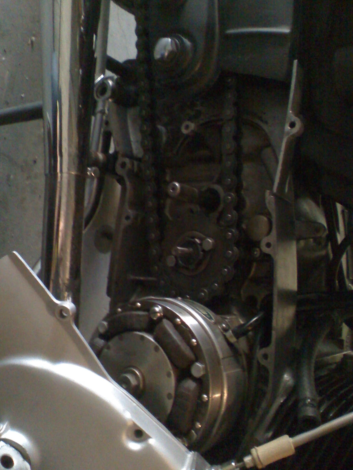

ok i tryed moving the kick shift to the right...it will only move maybe a quarter inch ...so i took off the tranmission side to see if that would "reset" the gears...still only one gear...i took a pic of the right side so maybe you could see if it looks as though something is missing...im lost at this point lol

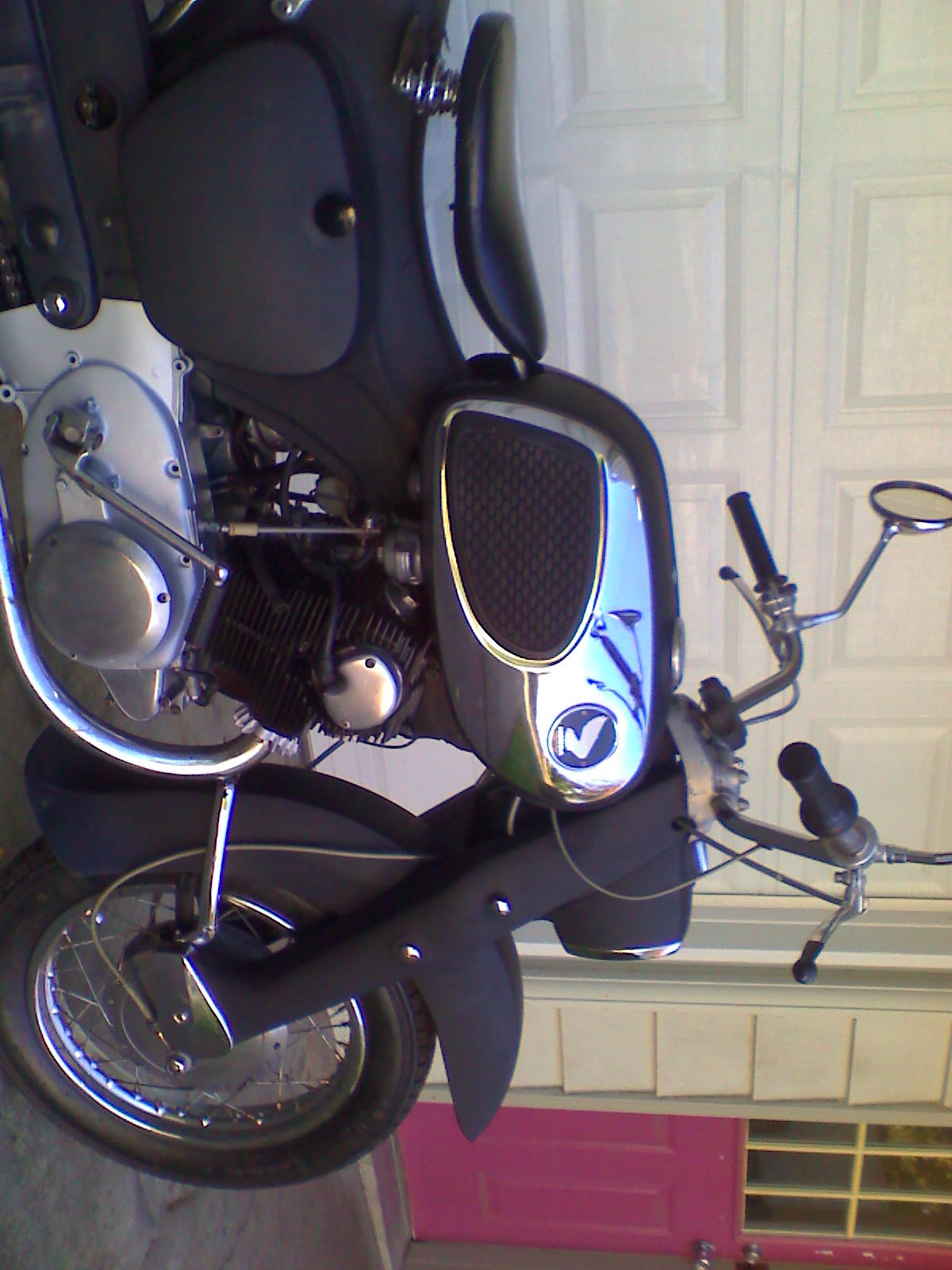

this is the pain in my butt looking good...but still giving me a headache
right side open
right side open

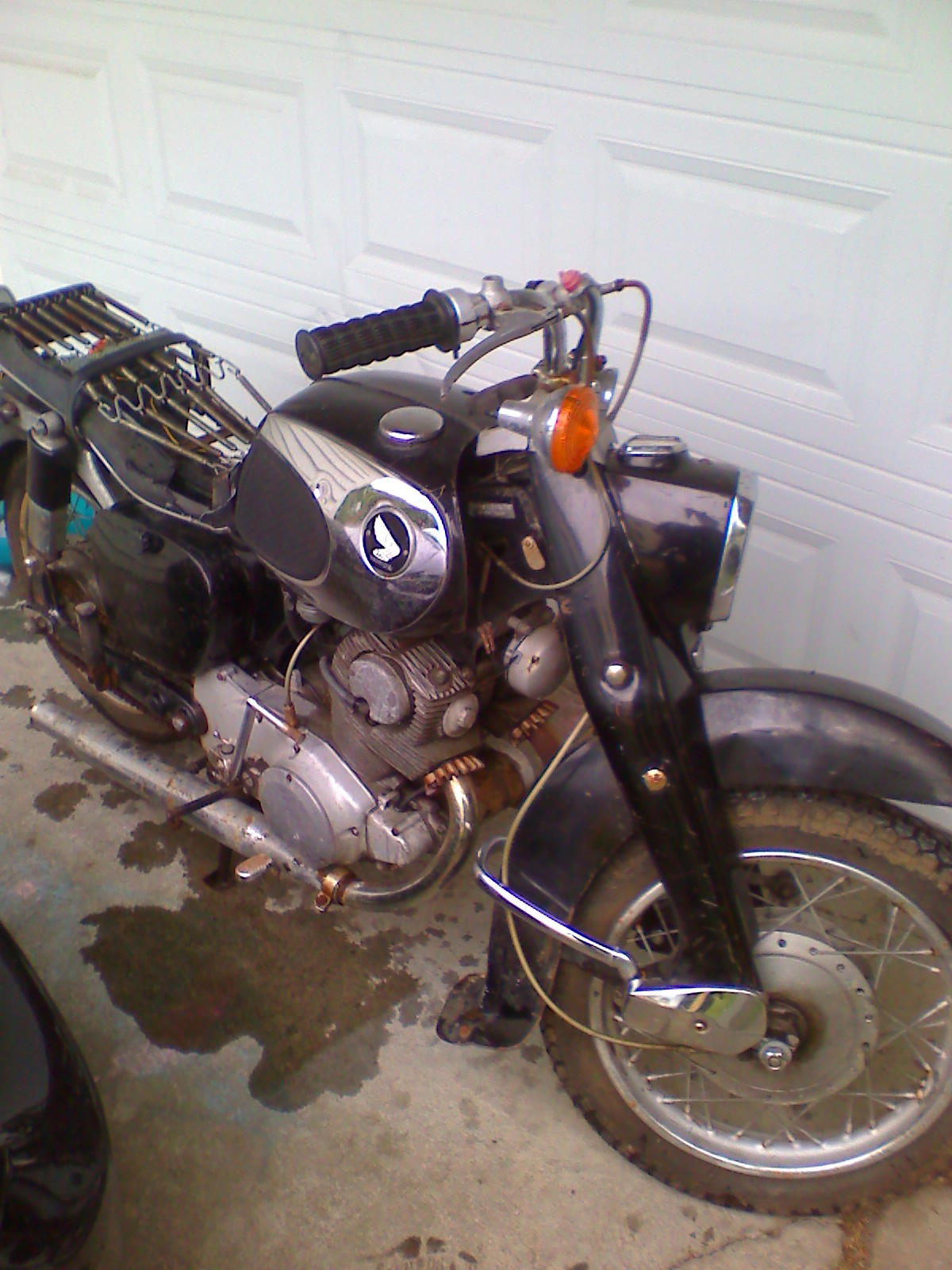

what it looked like when i bought it
Post by e3steve » Wed Oct 29, 2008 3:17 am
Can you select all gears with the motor stopped but by moving the rear wheel by hand?
