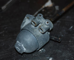

what are these called?
allthumbs
Posts: 131
Joined: Tue May 06, 2008 7:33 am
Location: Beacon, NY
Post by allthumbs » Sat Oct 11, 2008 10:39 am
the tube fittings that are missing here. anyone know what they are and where to get them?
thank you
rgtaylor2
Posts: 92
Joined: Sun Jun 17, 2007 1:00 pm
Location: Little Rock, AR
Post by rgtaylor2 » Sun Oct 12, 2008 1:32 pm
The two empty holes had connector nipples for the fuel lines to the carbs. They would have come out when the fuel lines were pulled so look at the ends of the lines and hopefully they will still be there and you can reinsert them and tap them back in place.
If they are gone the Honda parts manual does not show them as a replacement part so you will need to find another petcock to get replacements. Look on eBay and there is usually one available at a fair price.
Hope this helps.
allthumbs
Posts: 131
Post by allthumbs » Sun Oct 12, 2008 1:47 pm
I was hoping they were replaceable, I suppose my lathe will help me here
thx
rgtaylor2
Posts: 92
Post by rgtaylor2 » Sun Oct 12, 2008 8:50 pm
They should be just like the one on back side of the petcock in the picture, where the crossover line from the fuel tank was placed. Copy that x2 and your in business, I wish I had that ability to copy.
Post by e3steve » Mon Oct 13, 2008 10:22 am
One of mine pulled out too, but because my petcock has a split in it. How are these held in place -- we Brits call them spigots, the Spanish call them racors? How do they seal, I mean? I bogged mine back in with Belzona, but what's the norm?
Post by LOUD MOUSE » Mon Oct 13, 2008 11:11 am
Pressed in. ..................lm
e3steve wrote:One of mine pulled out too, but because my petcock has a split in it. How are these held in place -- we Brits call them spigots, the Spanish call them racors? How do they seal, I mean? I bogged mine back in with Belzona, but what's the norm?
RIDE IT DON'T HIDE IT!
Post by e3steve » Mon Oct 13, 2008 11:19 am
Thanks Ed. That sort of explains why there's a split in my petcock, if they're interference fit. Old alloy, I s'pose.
