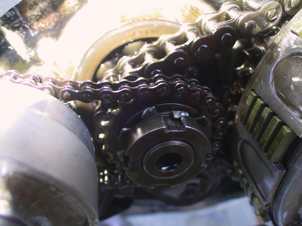

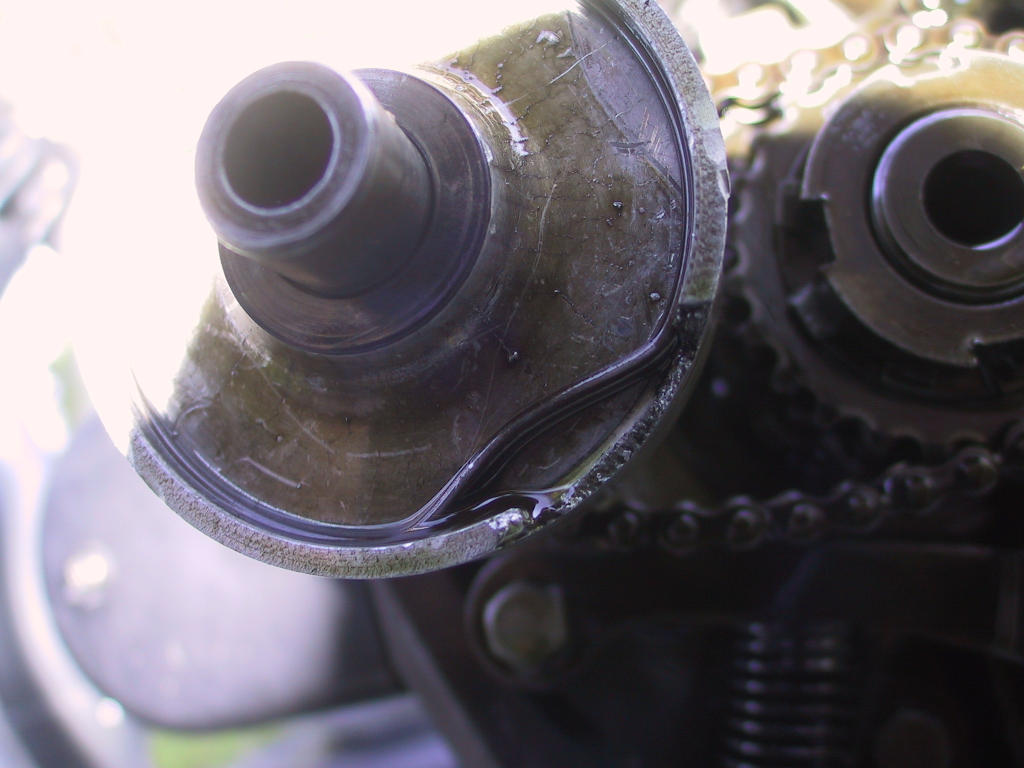

disturbing that I can't find the missing piece, but I guess that's whats in my oil. here's the damage LM, seems fine really, you think I should just run clean oil through it and reassemble? maybe I change oil again rather soon?
how does one clean the filter anyway
