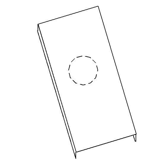

The place where the vac hose attaches to the cabinet has a sheet metal cover that helps reduce the amount of media lost to the shop vac. I drew a rough sketch for you. The cabinet SHOULD be constructed so it has essentially, NO LEAKS, so the only source of incoming air will be the compressed air, feeding the blast nozzle. That means there won't be enough flow volume going to the shop vac to loose much of the media. I have to empty and service the shop vac approximately every 20 hours of use.
