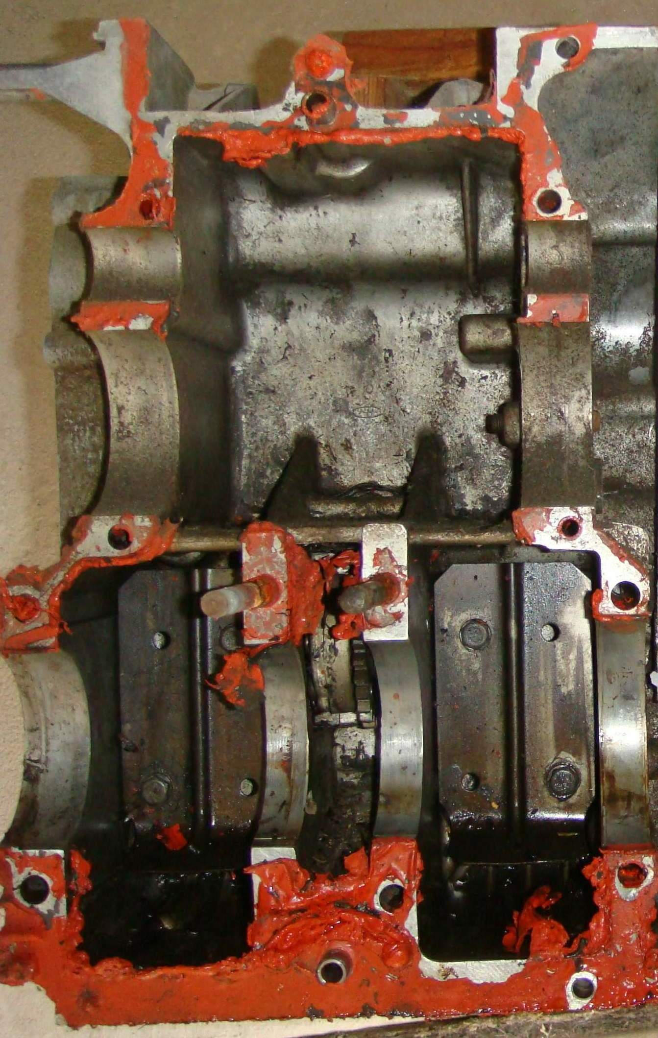

I wanted to get started posting some pics now that I almost have my CL72 apart... I couldn't resist opening the bottom of the original engine I have, I thought it felt a little light. luckily the bike came with a spare...
CL72E-310100
CL72E-310100

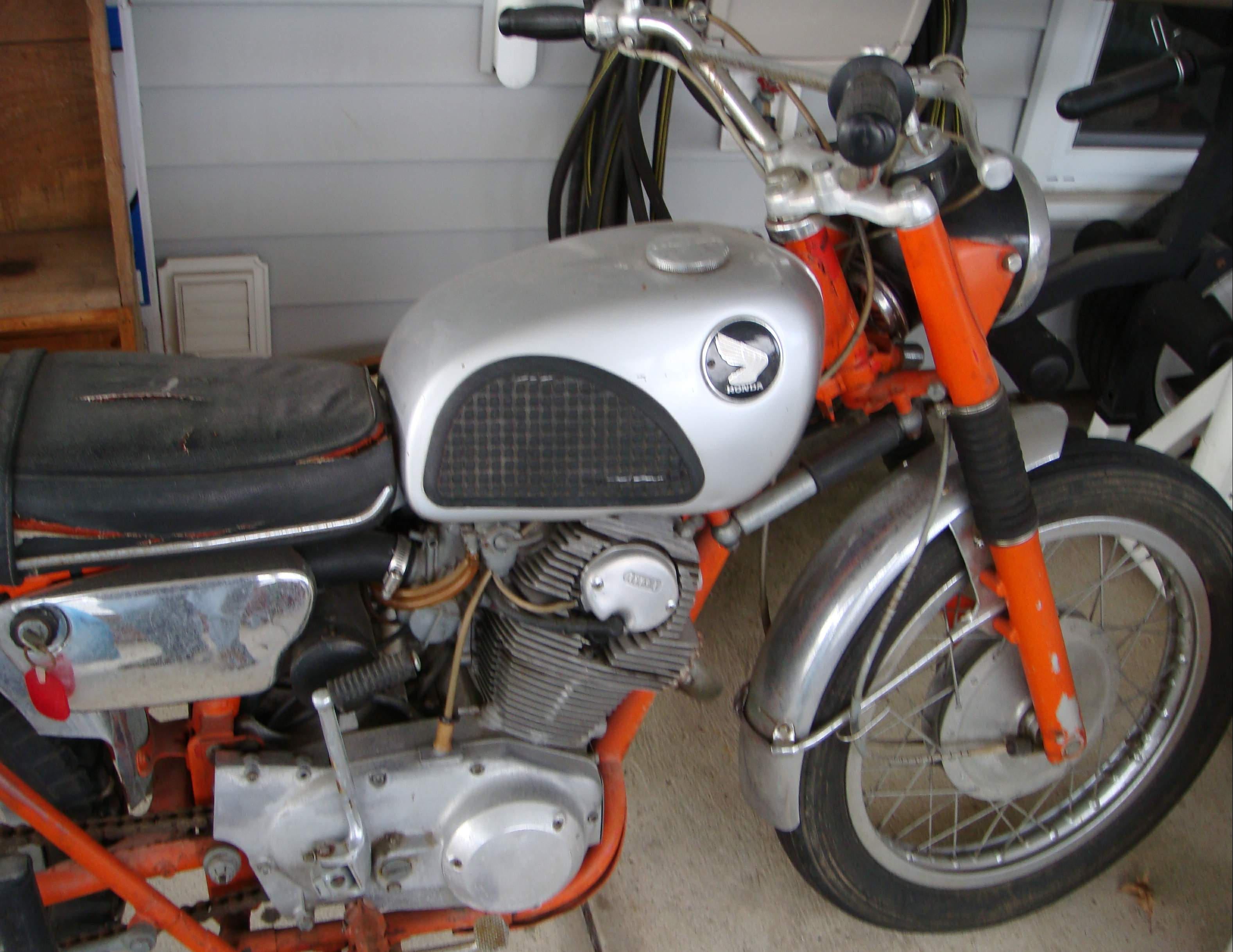

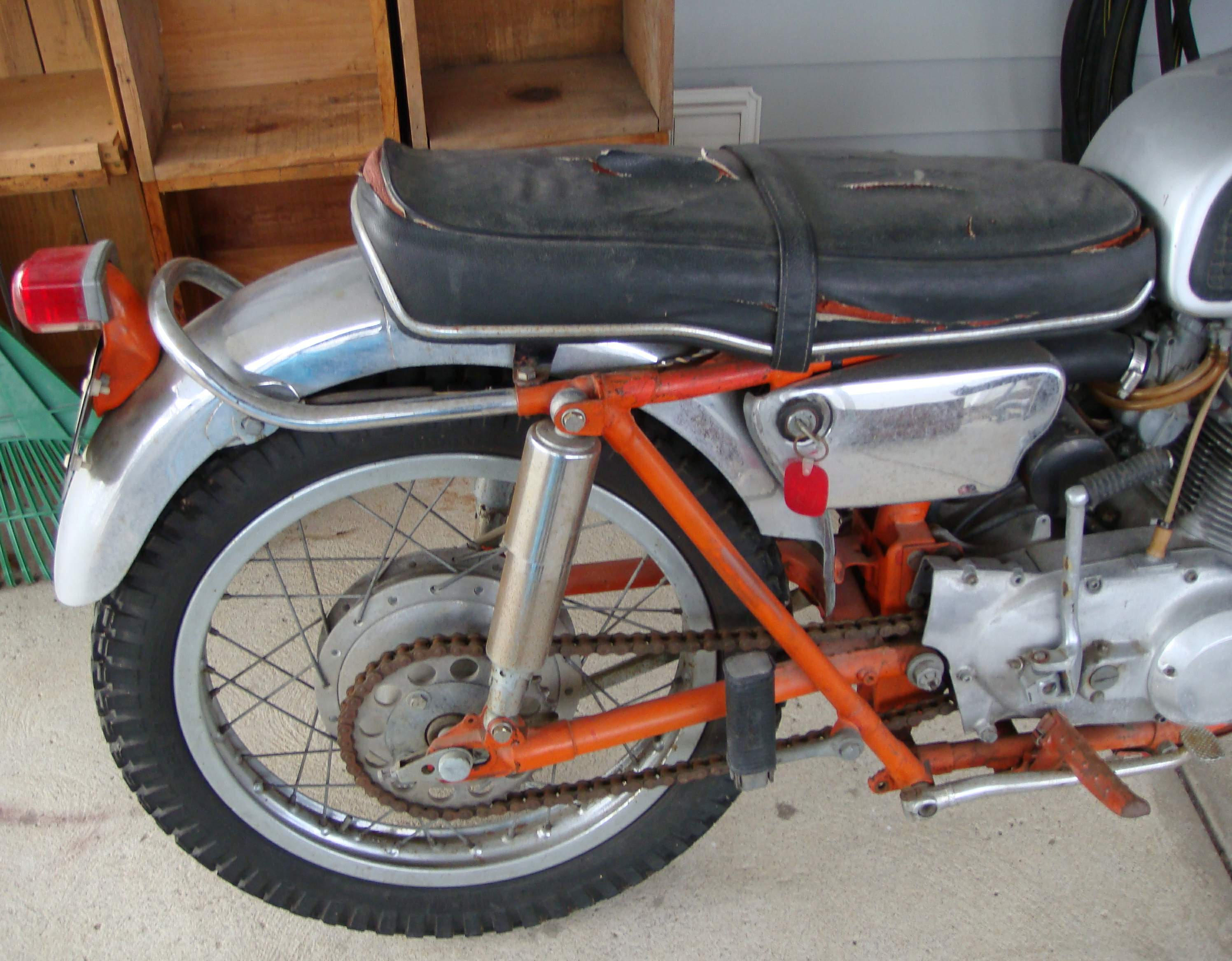

Here's what I started with, first thing I had to pick up was a kick-start lever (which hasn't weathered very well over the last ~15 years)... All I knew at this point was I had an extra motor in a box. I found this forum and knew I needed the books, although it did come with an original manual and a bunch of reciepts from 1978.

Ya say this is a CL72. May we have the frame and engine numbers. The bike looks to be a CL77 from what I see in the pics. .................lm

yes, LM, therein lies the trouble.... Frame #CL72- 310103 Engine #CL77E-1016184, motor in a box (the one noted above with the 5lbs of orange silicon inside..) CL72-310100. So best that I can tell it's a 1965 CL77 on a 1963 CL72 Frame. Seems a waste to have to do it up as a CL77 but the CL72 engine is missing one of the case covers, the complete tranny and by the looks of the previous work done, in need of COMPLETE overhaul... on a good note it turns... On the other case, just to get it looking good as a "hybrid" and rider, the filter covers have cracks, the front fender mount on the left fork is stripper/cracked, front fender is bobbed, tail light bracket has been "chopped" (as in ears removed), seat is gone but the pan appears to be in good shape (mind you it is a '63 seat)... I am thinking the only choice I have is to fix everything I can, get it running and not post pictures of it here on this board... ;-} From what I have seen around pre-1964 CL anything is not real common.. Your candid opinions and expertise are always welcome. -DC

What I see is a lot of 305 frame parts. Fenders and forks for sure. ....................lm
