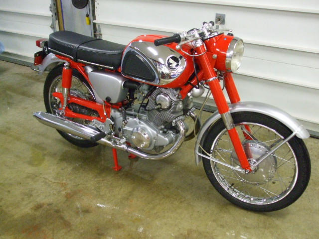

For what its worth, if you want to save a few bucks,and your not concerned about originality,go down to your local Autozone and by a quart of Duplicolor "Body Shop" paint. It's pre-mixed ready to spray lauquer.I cant recall the name of the silver,but they only have one.For $20 a quart you can't beat it and being lauquer,it looks original.You can also buy the clear to topcoat it.I didn't do that,just rubbed it out Looks more original in my opinion.
