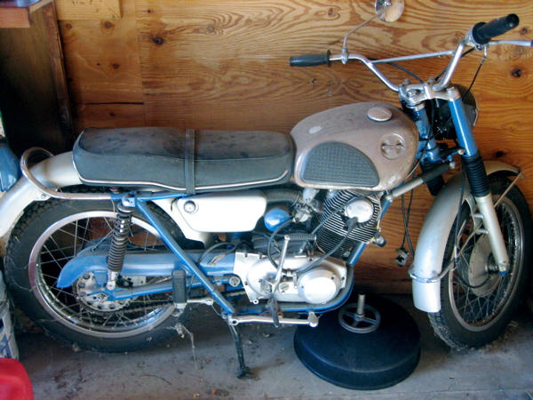

This is pretty much how I bought the bike.

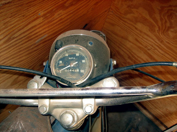

842 miles!
842 miles!

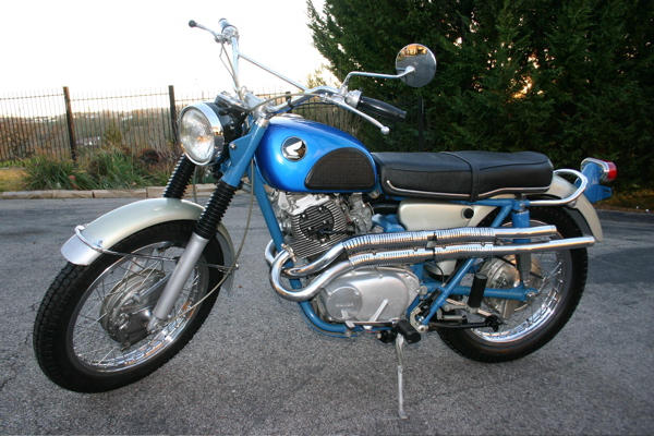

Washed, chrome polished, different tank and, tuned ready to go.
