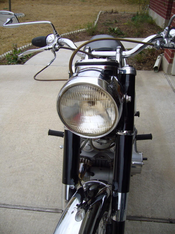

Question 1: Are my handlebars... based on the picture... the ones MEANT for a 1964? EG... my frame number? If so, then I can assume my part numbers are correct.
Question 2: If my bars are correct for my year then I guess all the early year cables I'm finding for the "straight bars" will not fit. True?

This bike was issued with the flat bars. ............lm

Hey Guys. I think I like these handlebars and want to keep them but I'm having a hard time finding cables... are these Low Rise Bars? Has anyone had any success with cables on these?
Or is it the general consensus that these look like crap and I really should go back to the straight bars?

It is a European half high handlebar (probably the same as on a CB450 European model)
