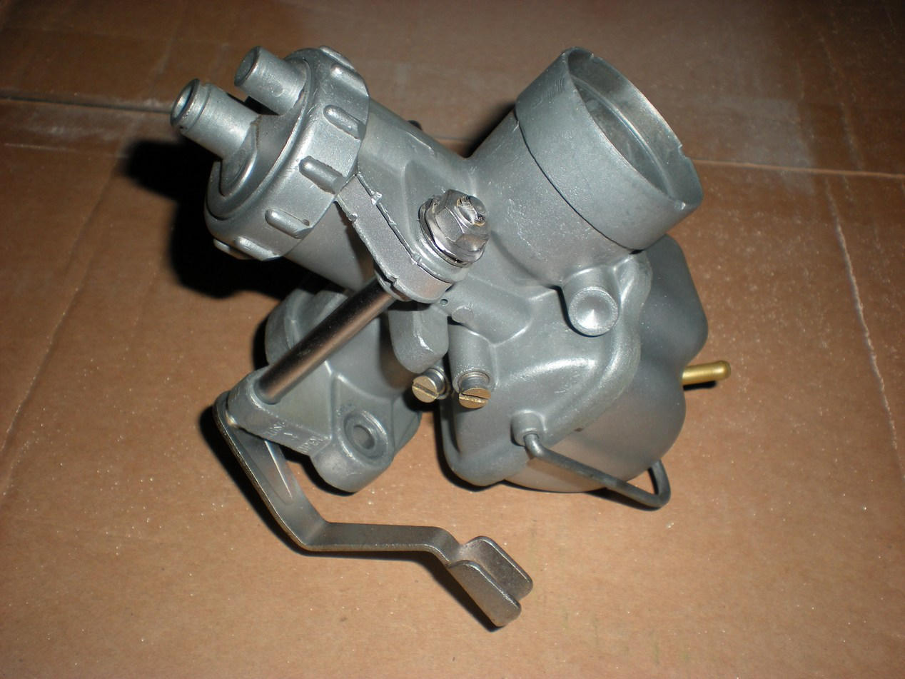

Thanks Fred. I ended up buying a new cabinet that came with a gun. It works great!!! I am very pleased with the results so far. I used glass media to blast my carb and it looks like new. I will post some pictures up as soon as possible. I heard that walnut was also good on plastic parts like the knobs that hold on the side covers. I might buy some this weekend and give that a try. So far everything is going great on my restoration of two 305 Dreams.
