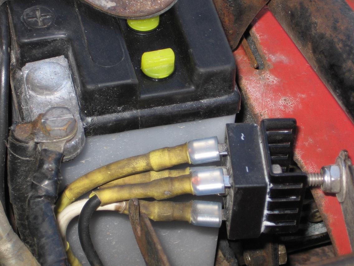

Here is a picture of how I mounted mine. I did use the paste between the regulator and heat sink. I also posted cool jersey that I just got from metroracing.com.
