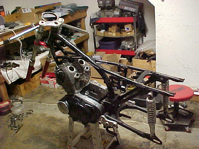

I'm starting the build on my CB77 cafe custom, and was wondering if I can run it without a battery? I have seen battery eliminators for sale, and am wondering if this would work. I am also considering installing an e-ignition, and will this be a problem with no battery? Has anyone tried this? I want to remove battery box and all brackets from frame before painting. Thaks in advance!

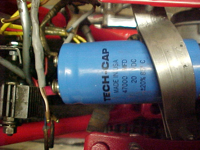

So, I found something on a google search that gave me the nubers to find a capacitor to replace battery. I can't seem to find the article again. I took the information to my local Electronic plus and the sold me the part in picture. I do remeber it was a " computer grade capacitor" The numbers on it are TECH CAP 47000 MFD, 20 VAC, +_ 20% 85 c . I think it cost about 50.00. I made a bracket for it, and so far the bike starts, and has done a couple of very short rides, as I'm still working on jetting the carbs for velocity stacks.
