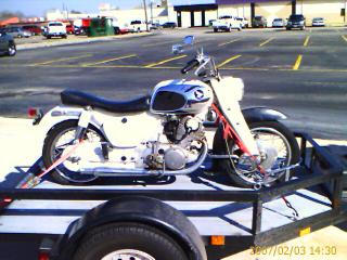

I brought it home and was ready to go. Then, I opened the gas tank... below is what it looked like when I brought it home. The second is off to sandblast and powder coat. I bought my own powder coater and oven, but can't fit the frame and front forks. I will do everything else.

How it came home
How it came home

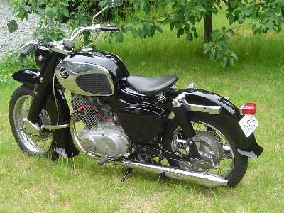

This is my end goal. Sorry if I stole your pick.
