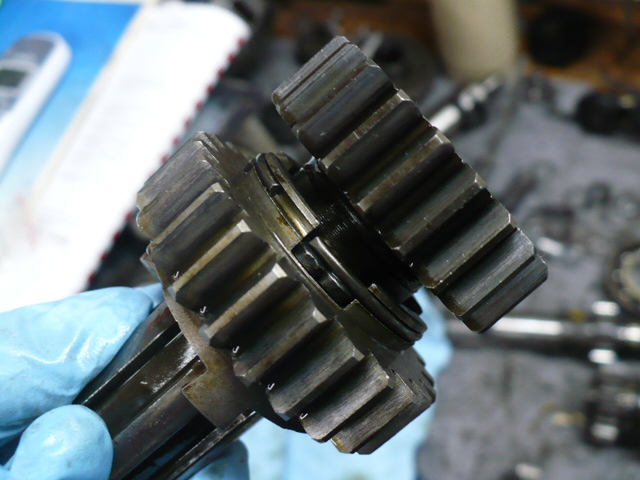

Steve, Good to hear from you. If there is anything I miss, don't make clear or incorrectly state please chime in. I am working sporadically on the bike. I am looking at my gears right now and will shoot over pics for Ed to look at. There is a little rounding of the dogs, I'm hoping not enough to warrant replacement. The gears on e-bay and other places are $100-$150. I can't see paying those prices. If the gears are good then I'll be posting the Xing gears procedure.

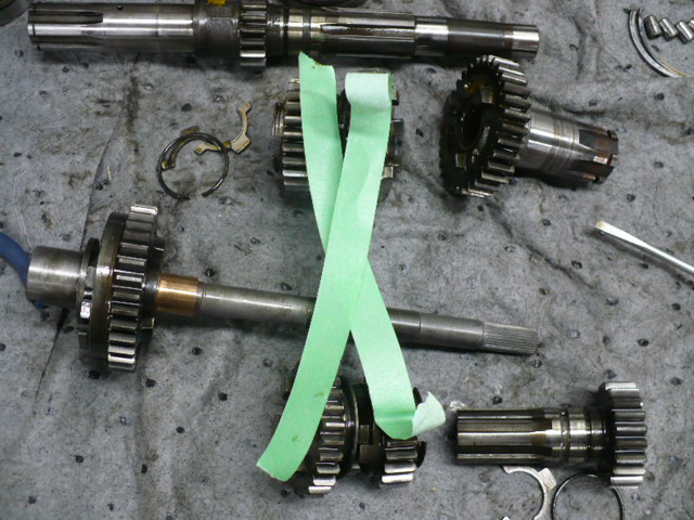

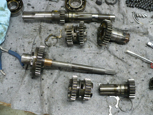

Now it is time to look at Xing the gears. I put the main shaft and counter shaft down as in the parts manual so I could count teeth and make sure that I either had the stock arrangement or see if the trans had been previously X'd. I slid everything off and kept the gears in order. I counted teeth ansd sure enough I had the stock setup, 27T 2nd gear counter shaft- 23T 3rd gear counter shaft, 24T 2nd gear main shaft- 29T 3rd gear main shaft.

I don't know how to do the photo shop tricks, so I used tape to show the X'ng. The deal is you're switching places with the 29T 3rd gear main shaft with the 27T 2nd gear counter shaft and switching places with the 24T 2nd gear main shaft with the 23T 3rd gear counter shaft.

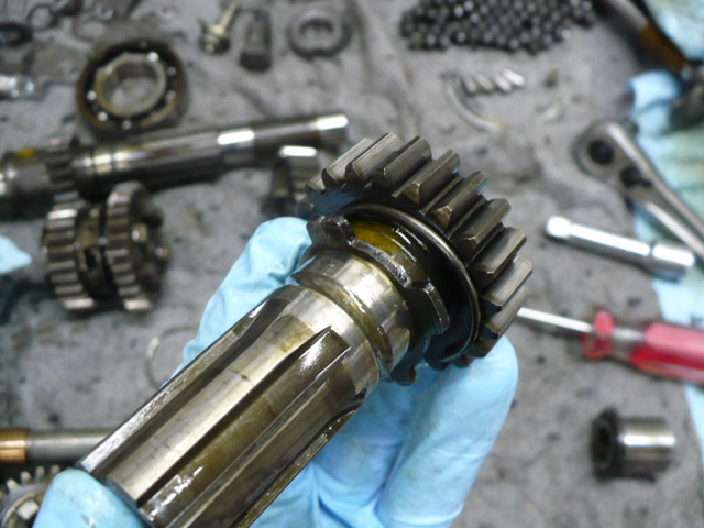

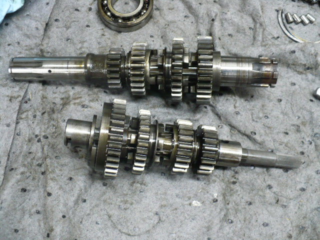

Slide your set ring down the counter shaft and put your cotters in. Slide your 24T 2nd gear down and slip the set ring on and you're golden.
