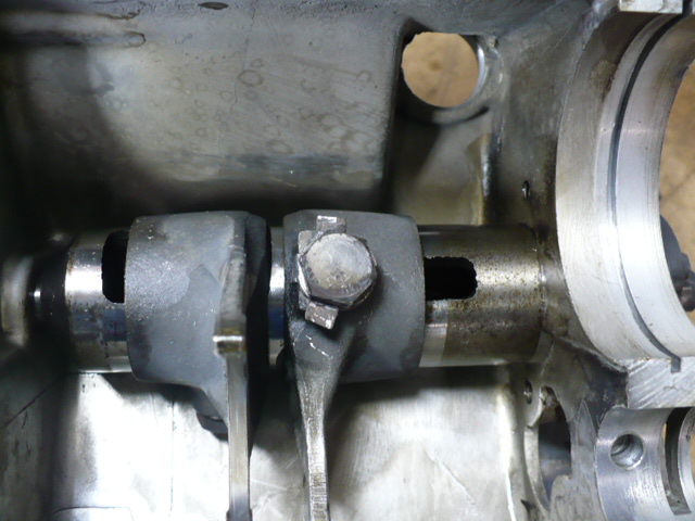

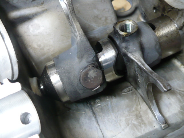

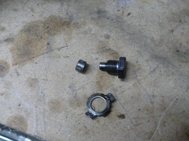

Time to remove the shift drum and shift forks for inspection. You'll need to bend back the lock washer tabs before unscrewing the shift fork guide pins. Mark the shift forks with a marker L & R because if they only have wear on one side you may be able to swap their positions exposing the unworn sides to service.

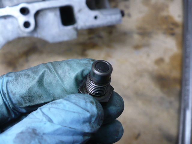

Post by Hoosier Tom » Sun Mar 06, 2011 10:27 am

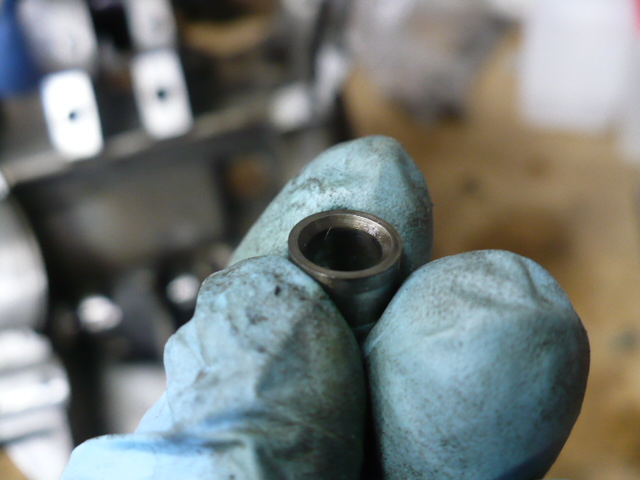

When you remove the shift fork guide pin make sure you get the little roller out that sits on the pin. You'll notice that roller has a bevel cut inside, and that end goes down on the pin. You don't want that end facing up. I have it photoed as it should be oriented.

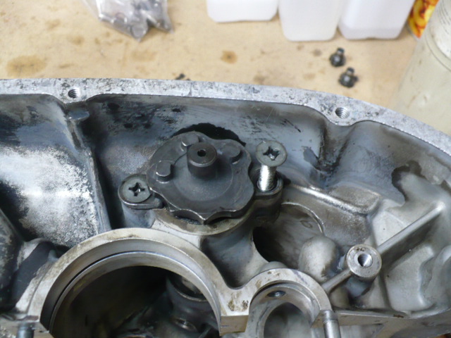

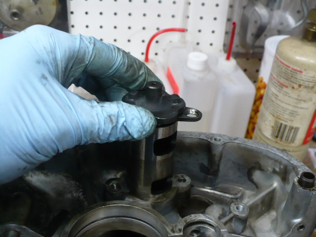

Post by Hoosier Tom » Sun Mar 06, 2011 10:33 am
Time has come to remove the assy. There are 2 screws to be removed that hold the shift drum setting plate. Before I mess with removing the shift fork pins I loosen the screws. It usually takes a couple whacks with an impact driver to loosen them. Remove the screws. To remove the screws you will need to rotace the drum for clearance on the heads. You will see what I'm talking about when you do it. Now just lift the drum and plate straight up and out. The forks will fall out loose in the case.

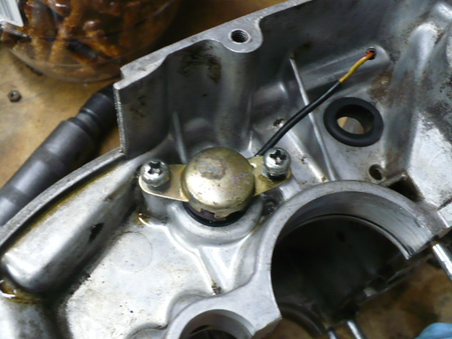

Turn the case over and remove the neutral switch and then the oil seal. It usually takes a couple whacks with the impact driver to loosen the screws.
