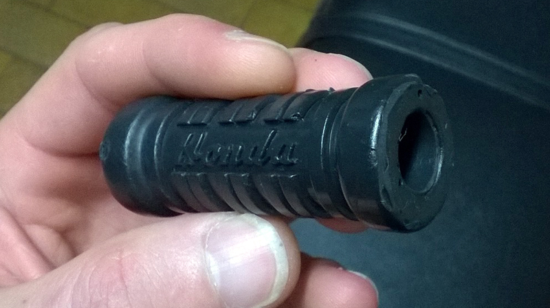

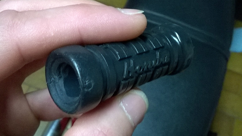

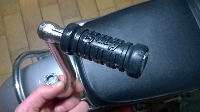

Got this in from ClaussStudios.
At one side the gap is larger... Is this side supposed to be at the end of the kickstart lever as shown in my first picture? Text is facing inwards then when the kickstart is mounted, don't know if this is meant to be by Honda or a fault in the mold.

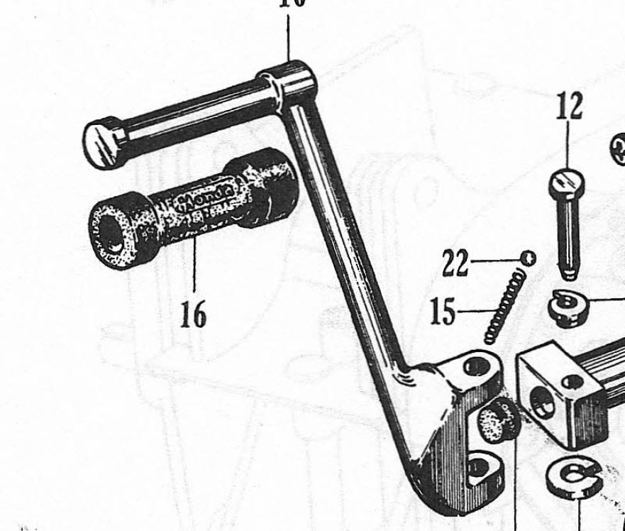

Post by Geeky160 » Mon May 29, 2017 6:27 pm
From the '66 parts manual. I guess it could be wrong.

When new the knob fit into the recess. ......................lm
