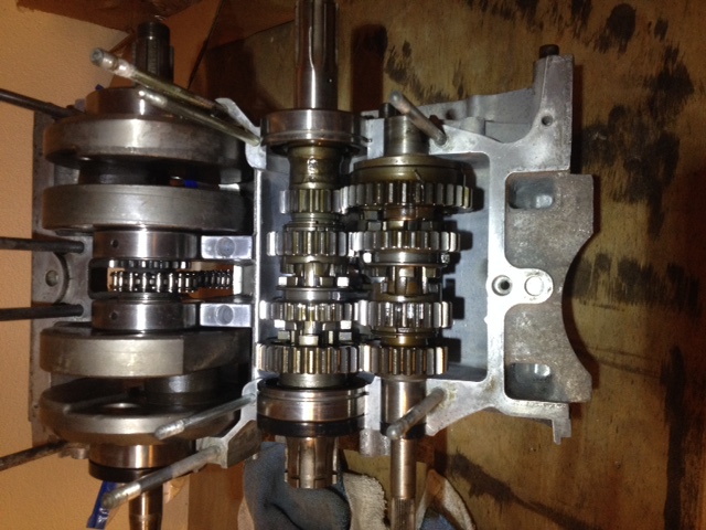

Brickyard wrote:New pistons and rings installed.
Got Bill Silvers engine book open to guide me through reassembly.

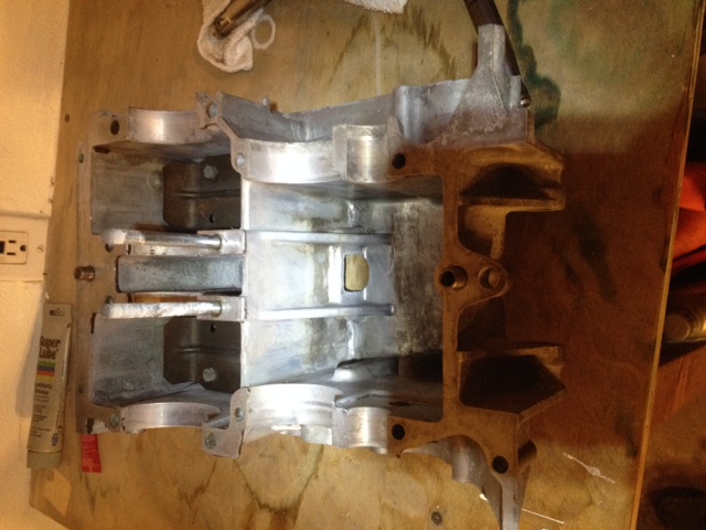

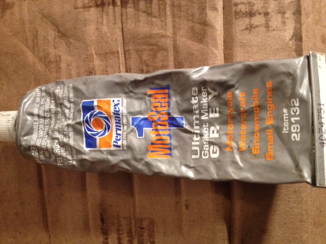

At this point I'm pretty nervous as this is the first time I've split the cases and put them back together. The worry of "maybe I forgot something" is hard to overcome, but I checked and checked again. Bill Silver said an alternative to Hondabond is this permatex ultimate gasket maker; it's what I have, so it's what I'll use...
Post by G-Man » Fri Nov 06, 2015 3:40 am
Brickyard
Just use sparingly and keep it out of those oil galleries. Did you clean the oil filter after finding all that muck in the oilways?
Brickyard wrote:At this point I'm pretty nervous as this is the first time I've split the cases and put them back together. The worry of "maybe I forgot something" is hard to overcome, but I checked and checked again. Bill Silver said an alternative to Hondabond is this permatex ultimate gasket maker; it's what I have, so it's what I'll use...
Post by LOUD MOUSE » Fri Nov 06, 2015 7:36 am
I'm going to get a tube of that. ...............lm
