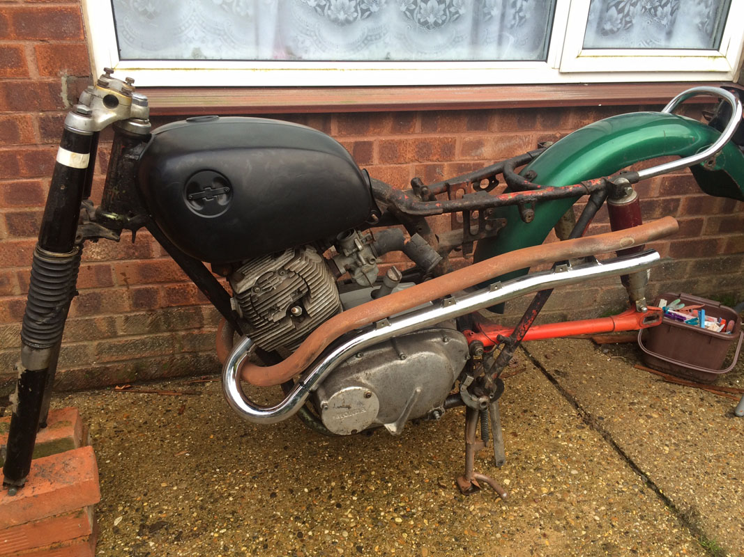

Post by thepunisher2007 » Fri Aug 18, 2017 11:02 am
Before
Before
Before
Photo 21-02-2016, 09 42 47.jpg (201.48 KiB) Viewed 2427 times

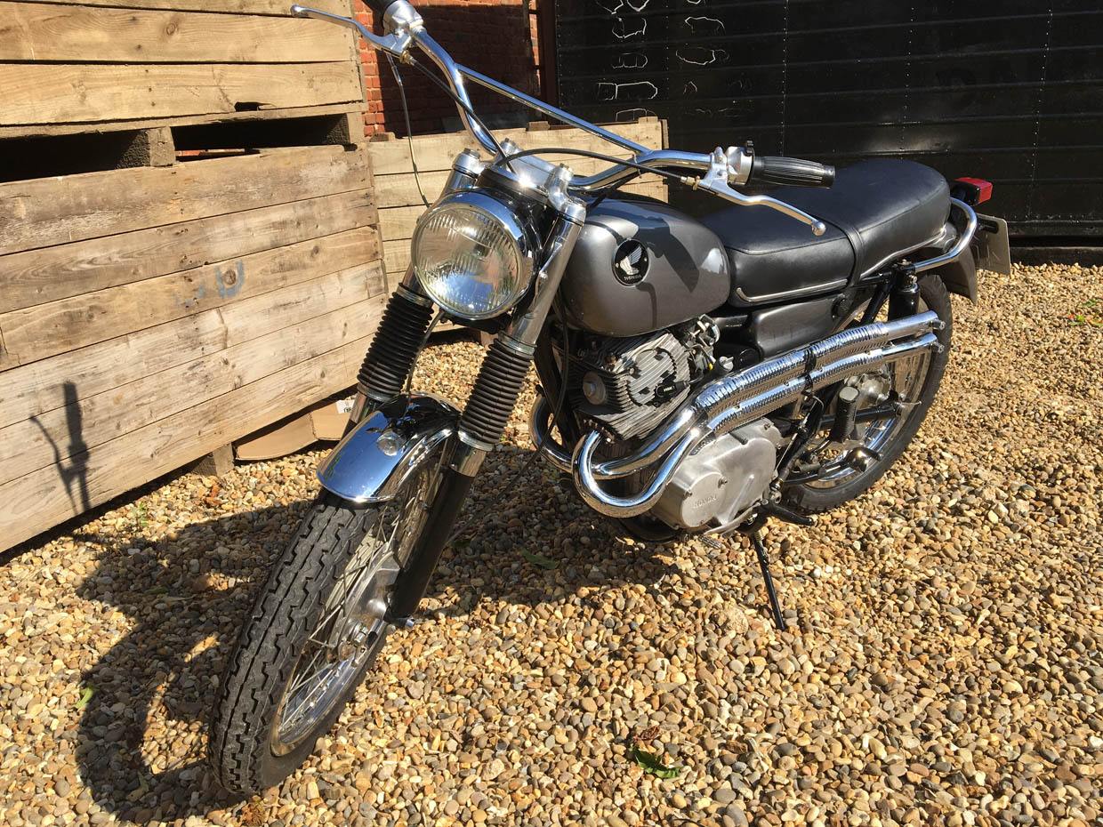

Post by thepunisher2007 » Fri Aug 18, 2017 11:07 am
After
After
After
Photo 17-06-2017, 09 05 241.jpg (342.25 KiB) Viewed 2423 times
