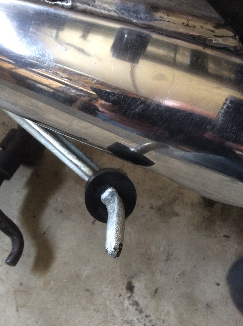

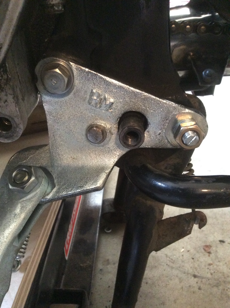

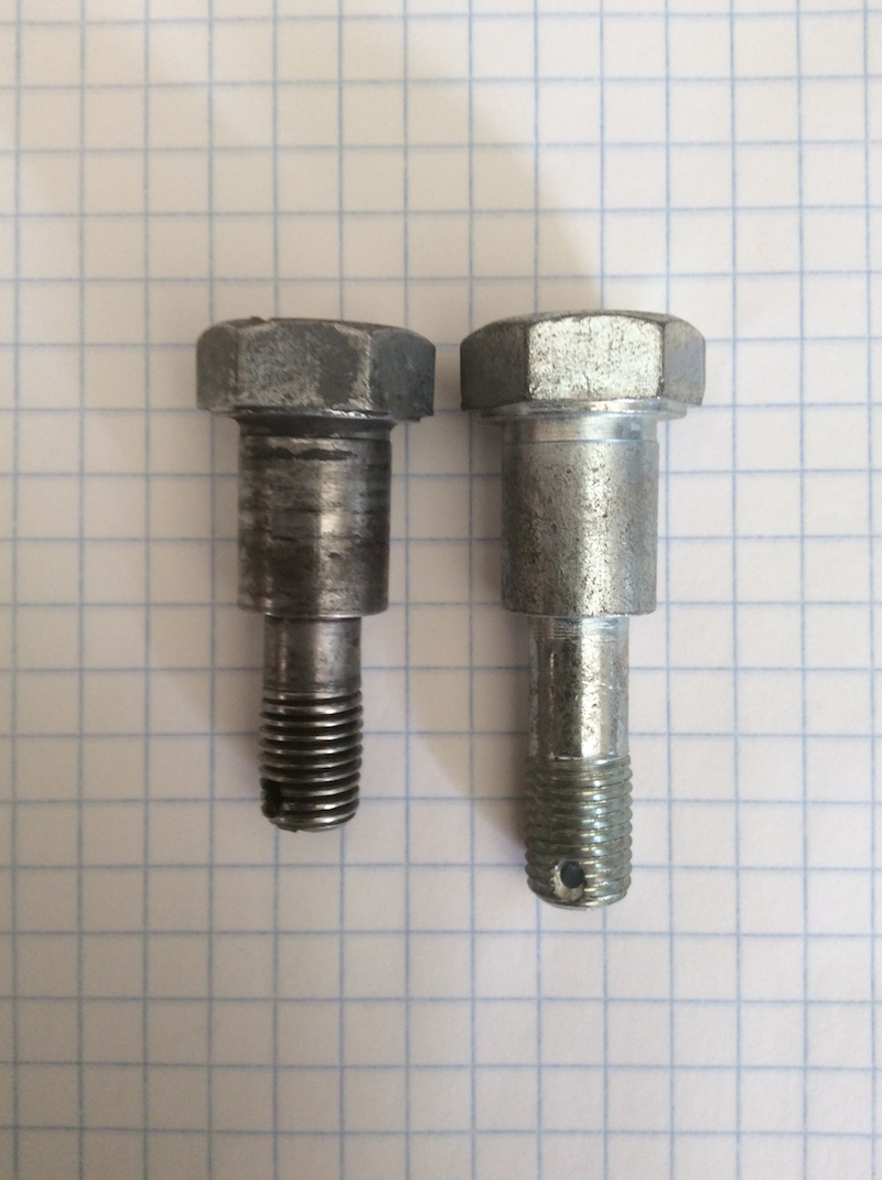

I received a reproduction side stand from Thailand and decided to install it today. I had previously bought the longer center stand bolt and a longer lower left engine mounting bolt. Installation was really simple. I had anticipated that the center stand spring would pull the mounting holes out of alignment when the bolt was removed and it did, but it was easy to pull the stand back in order to insert the new longer bolt. I torqued the new bolts and added a third 6mm bolt to the center hole, since there was a corresponding hole in the frame for it. No bolt was installed there on the old stand I'm replacing.

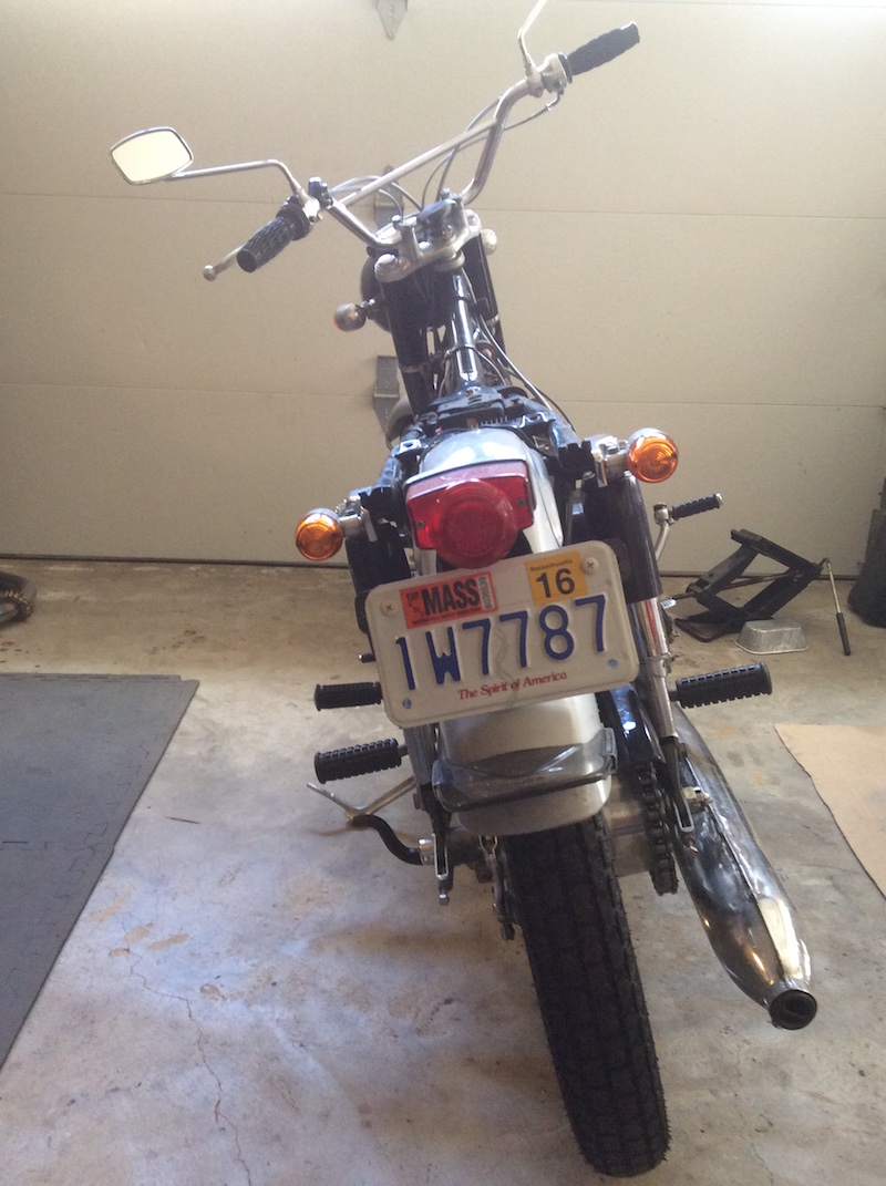

On the new stand, the lean is less than the old stand, but it still seems a bit much. I'll be able to judge better when the tank is back on. One thing that surely did not change with the new stand is that it contacts the bottom of the muffler along it's length, rather than at the rubber bumper. I don't know why.

I too fitted one of these side stands and at first I had the same problem so I sat down and had a long think the stand needs to be angled down more and I achieved it.
I will try to explain im not too good at explaining things.
You will need to install angled washers they will look like wedges make a think washer and make it into a wedge you will need both pices of the wedge one under the bolt head and one were the stand touches the frame new wedge washers for all the bolts the angle of the wedge you can work that out.
Also it will lift the bike more upright and not lean at such a angle also the rubber stop now hits the muffler how it should, hope this helps worked well on my CB77.

Many thanks SMBH, I understood your explanation perfectly. Were the mounting bolts long enough to take the extra thickness of the angled/beveled washers on either side of the side stand bracket? I've seen these washers in sets somewhere, but I cannot recall where.
Another idea might be to mill both sides of the mounting bracket around the bolt holes to make up the angle. It would take a talented machinist to do that though.

It's your bike you do what you want with it, im no expert machinist the angled washers I made up were just me and a hacksaw and file they worked very well.
