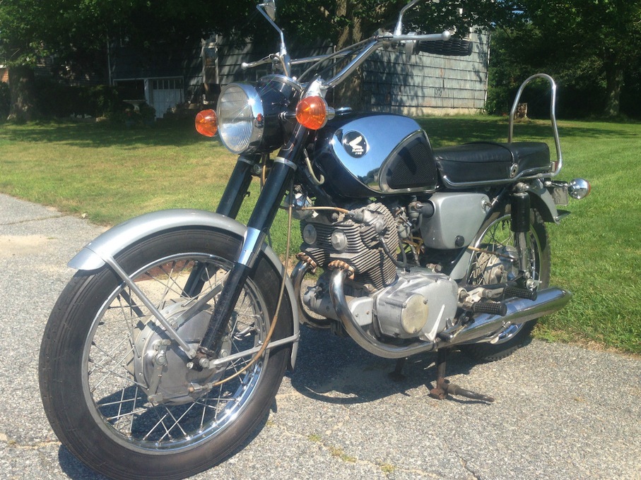

Late last August (2015), I picked up a running '64 Super Hawk in pretty good condition, but in need of minor repairs, replacements and upkeep. I have no intention to fully restore the bike at this time; perhaps after I complete my never ending '64 Dream project. The purpose of this thread to record and document changes, as well as my learning experience.

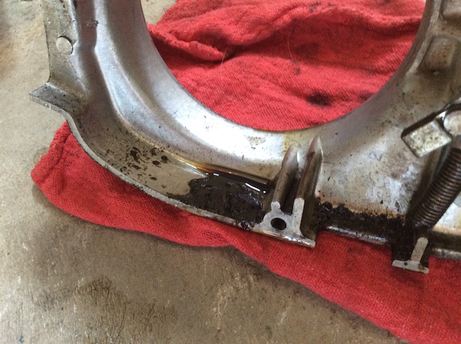

Yesterday, I started to replace my clutch cable, but, as with many such projects, the job suddenly snowballed. Previously, along with the crud of ages, I had noticed a bit of oil on the underside of the engine and suspected a leaky seal. I was prepared with a replacement seal kit before I started disassembly.
Removing the right engine side cover screws was typically challenging, but with an impact screwdriver, I managed to save all 8 of the original screws. Inside was a very dirty chain and the usual nastiness that goes with it. Also a bit of oil in the stator area.
I removed the drive chain, the front sprocket, the stator and the rotor. I also had to remove the starter motor so as to remove the starter chain. I had to drill the heads off the upper and lower 6x20 pan head screws because the impact screwdriver just couldn't do the job. I found the back of the starter sprocket to be soaked with oil. The large seal looked fine, but will be changed with all of the others.
Cleanup and reassembly ongoing.

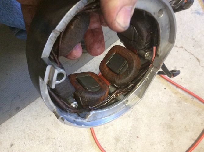

Oil soaked stator

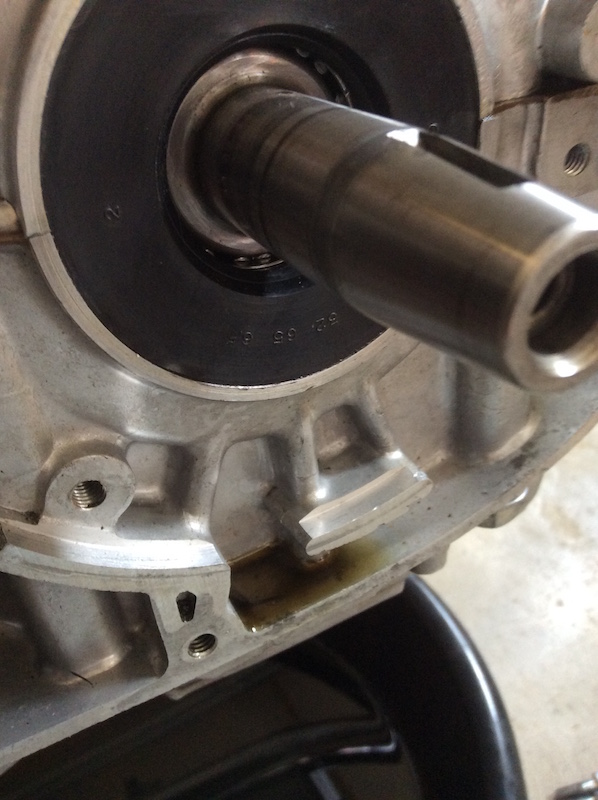

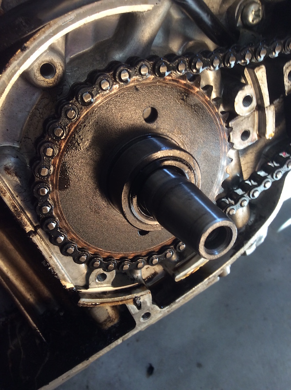

Started work again this morning and found a very small amount of oil below the rotor. Off it came. I found no leaks. All that I can think of is that few drops were from oil remaining in the starter clutch area. I reinstalled everything, but had to change the starter clutch springs, caps and rollers because everything fell out in disassembly and one spring took a walk. Luckily, I had a new starter clutch kit on hand.
I have replaced the main bearing seal, the seal on the starter sprocket and the clutch push rod seal, but decided not to change the others right now.
I reinstalled the cleaned drive sprocket and chain and sprayed the oily stator with cleaner. I must replace the brittle and broken wire cover before the stator can be reinstalled. While I'm waiting for that, I drained the oil and removed the oil pump.
The oil pump came out with a little gentle persuasion, but the screen took a bit more work and, while removing it, a 6mm nut dropped out of the engine case. That cannot be good.... I've cleaned both the pump and screen and should be able to reinstall them tomorrow and add fresh oil.

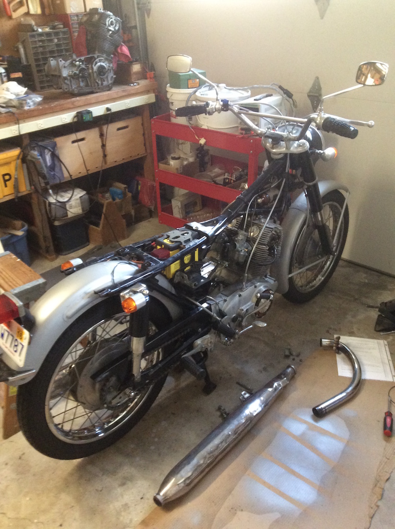

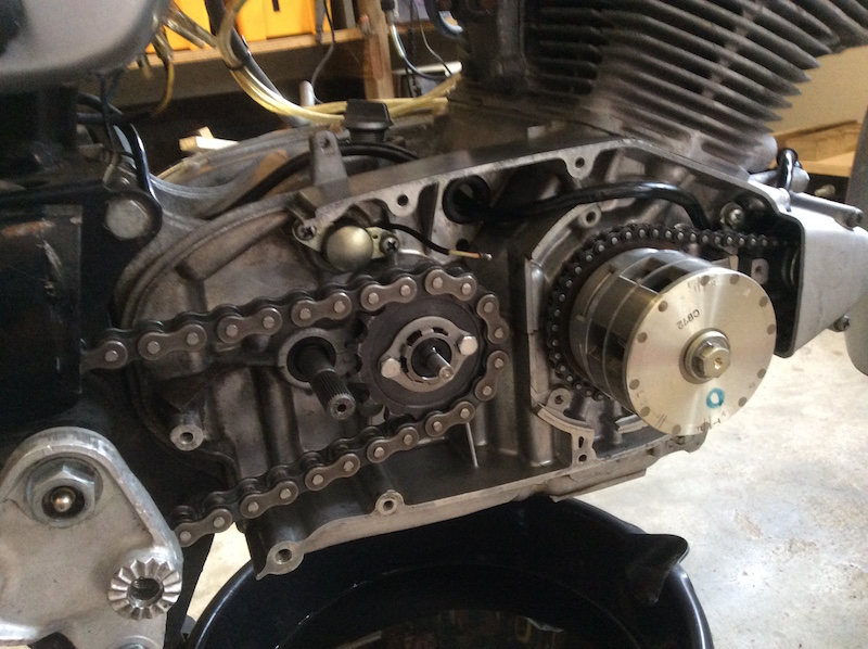

As it stands at the end of the day

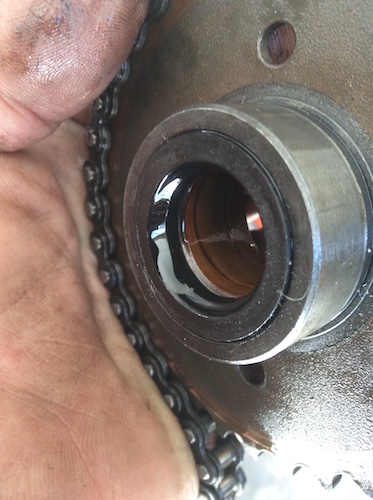

A few drops of oil.  Mystery source.

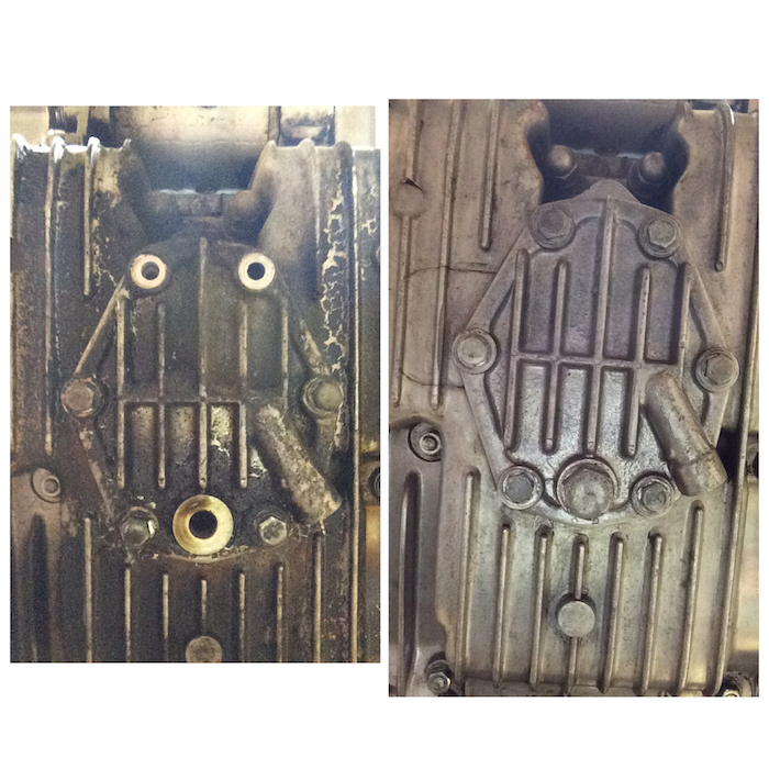

Replaced the cleaned oil pump with new gaskets and crush washer. Cleaned and reinstalled the oil filter (with appropriate difficulty) and added new oil. I took some time to clean the bottom of the grimy engine. Lubed the drive chain.

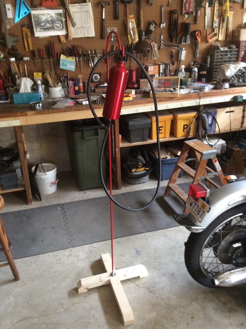

Removed the carbs, stripped them and gave them a thorough soak in carb cleaner. Reset the floats, reassembled and reinstalled. I'm now slowly going through a tune-up. Removed the points, cleaned them and replaced the missing adjuster screw on the right set. Stopped work to make a auxiliary fuel container so that I can run the bike and make adjustments to the carbs without the tank. Had a heck of a time with static timing. Electronic ignition is looking better and better.
