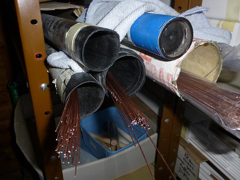

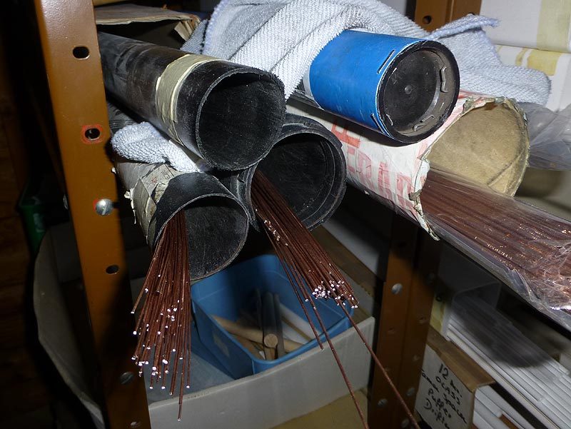

Our welding wire is supplied in these black polyprop tubes, they are 1m x 40mm & would probably be ok to make the tubes from, very easy to cut & heat-form the flange, trouble is, we throw them away!!

Hi Modelman, that should work ok.
