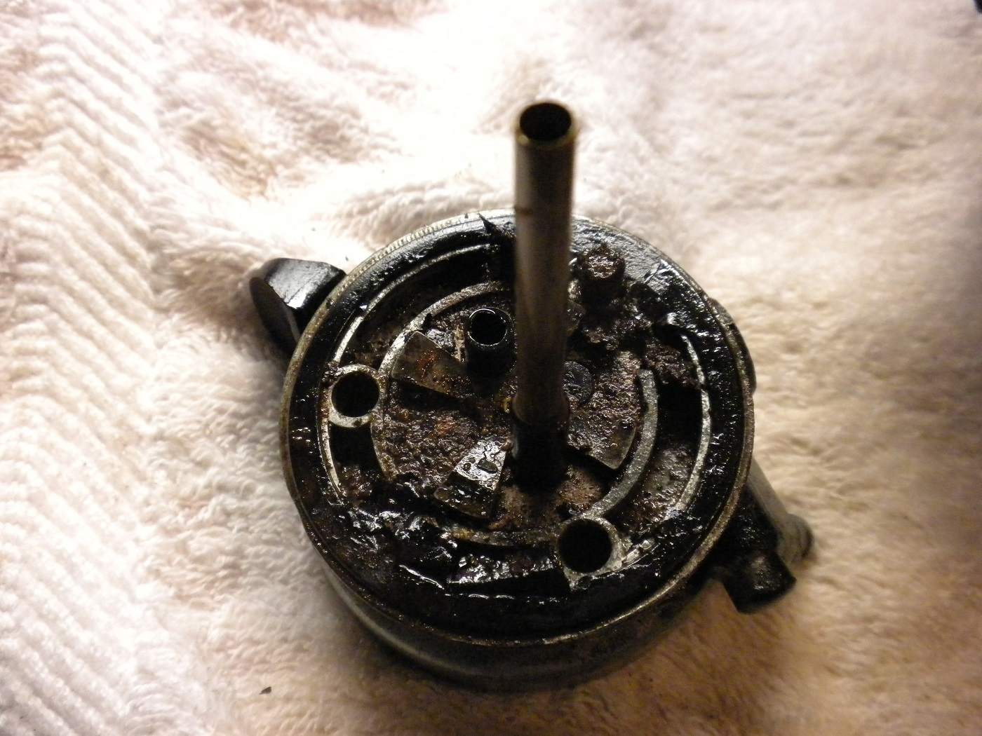

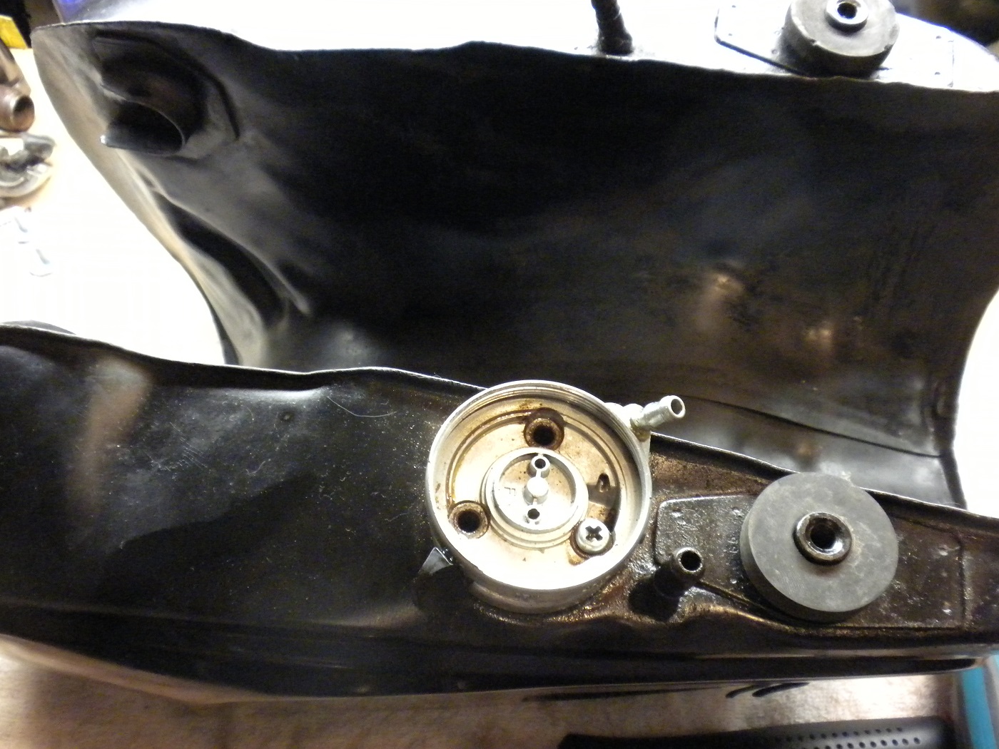

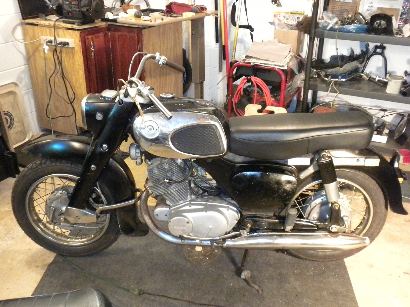

Made a little progress over the last week, (although, as of this writing, more gremlins were identified...)
I was able to remove 2 of the 3 screws holding the body of the petcock on, the third one had other ideas. Somewhat gentle impact driver, PB, heat soak, repeat. 3 days later it complied. A complete cleaning and reassembly, and no leaks! Of course, I assume I've tightened it so much to the tank, that the slide lever takes two hand to move. Put it on the list. But with gas and oil ready, new plugs and the battery charged, it was time to finally hit the button. The good news was that the starter motor spun (I was told it might not work), but the engine never fired - no spark. After an exhausting 3 hours of checking everything I (and a friend) could think of, we finally, and accidentally located a bad ground, where the wire from the condenser was just touching the points plate. I am not all that talented when it comes to mechanics, but when it comes to electrical...forget it. Fixed the ground issue, and she fired right up! Pics of the nasty petcock, and one of the bike after it was finally started.
