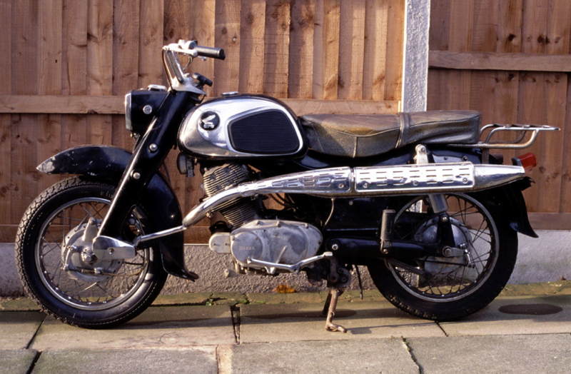

Post by G-Man » Sun Jan 26, 2014 4:35 pm
Steve
You're probably right - that makes more sense. A friend has one of those. There's a guy in Asia who occasionally makes pipes for the CS bikes. Paul Stassmaier got some for his CS72, I think.
My friend has one.
CS77 small.jpg (67.28 KiB) Viewed 2237 times
Post by e3steve » Sun Jan 26, 2014 4:58 pm
Very cool-looking machine. Not good for riding in hot climates, though; you'd certainly end up with some betty swollocks!
I've found a pic that I have of a CS92. I think the pics of the 72/77s are in paper format, back in UK; I'm in Spain just now.....
Post by G-Man » Mon Jan 27, 2014 2:58 am
That does look nice. Not sure I'd want to go trail riding on a 125, though. Unless it was all down hill.... :-)
Have a look at Paul's posts on here - he made a gorgeous job of his CS72.
